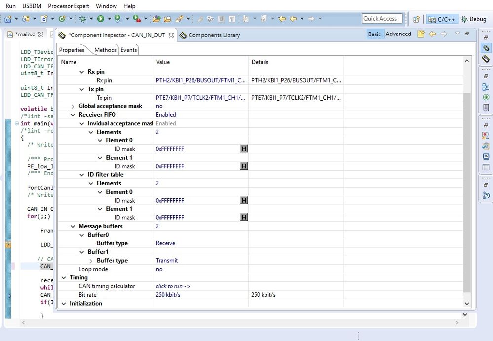

I am using the FRDM-KE06Z development board which has MSCAN.
Using Processor Expert I was able to receive and transmit data through the CAN perfectly.
What I can not do is understand how I can filter some specific CAN IDs.
For example, would you like to only get ID 0x7E8 what would the filters look like?

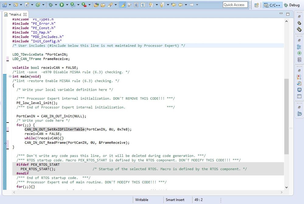

In the processor expert component has a function called CAN_SetRxIDFilterTable (Drv, ElementIndex, AccCode).
already tried to use this function with the values CAN_SetRxIDFilterTable (Drv, 0U, 0x7E8) and I continue to pick up all the IDs of the CAN bus and not only the 0x7E8.
Could someone help me by sending a sample code or helping me understand how it works?
Here is the screen print of my program and settings.

Hello Caio Carriel,
There is a same question with yours,  and it describe the filter detaily ,
please have a look:
KE06Z CAN_LDD filter
Then If still have any question aobut this , please tell us .
