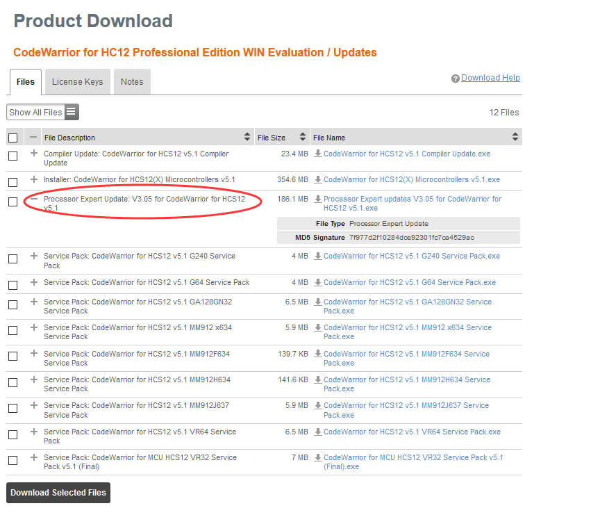

Hello Arunraj K,
You can try to install the Processor Expert update , while I haven't test it .
If it can't work, I think you can choose CW5.1.
About download the PE update , please go to the CW5.2 download site, then choose "Previous " button,
select 5.1,
https://nxp.flexnetoperations.com/control/frse/download?agree=Accept&element=5901341
then :
Hope it helps

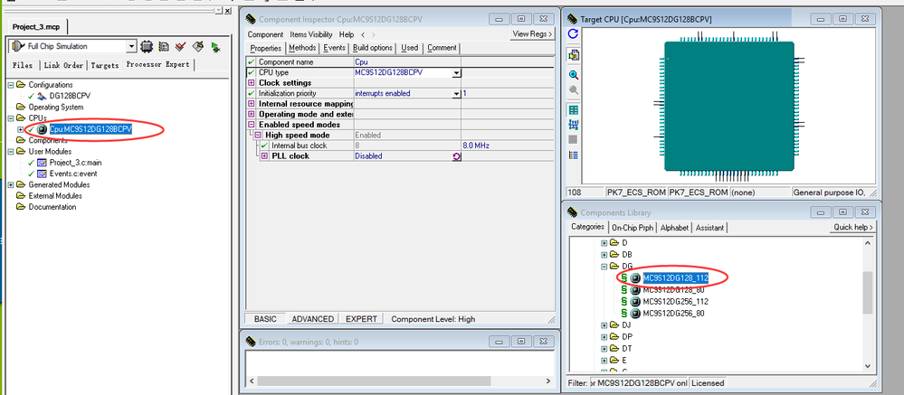

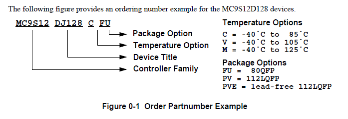

Hello Arunraj K,
You can use the cpu component  as below :
please have a look at the part number meaning :
Hope it helps

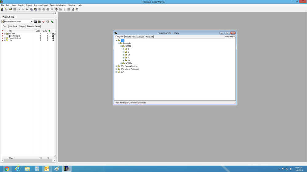

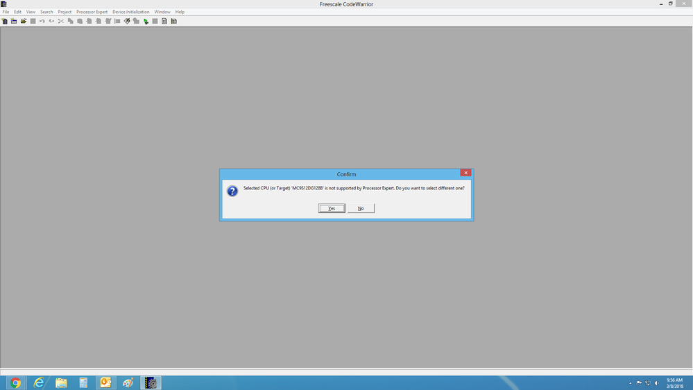

arunrajk
Fresh Out Contributor
Hi yang,
Thanks for the reply. I think my way of questioning is wrong. My problem is that mentioned CPU is not found in the processor expert menu. what can i do for getting that particular cpu in my processor expert menu?
My Processor expert menu screen short is given in below,
When i creating the project the error was like in below image,
