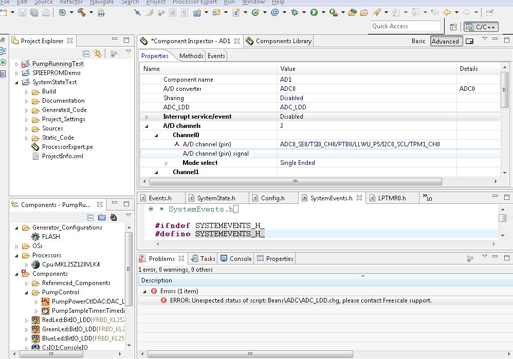

I am doing some test with KLZ25 board with Processor Export.
When I add a ADC component, it works well.
but when I disable its interrupt, there will be an error:
I can not figure out the problem. Does it mean I can not disable the ADC interrupt?

Hello Henry,
On my side , when only add the ADC_LDD component , disable the interrupt , there is no error :
Please tell me which Processor Expert you use ?
And i think it is maybe not the problem of disable the interrupt.
Please create a simple project ,only add the ADC component, then test it .If still have error , please send you project to me , i will test it on my side .

henryxin
Hi Alice,
Thanks for your reply.
But I tried to create a simple project which only has an ADC component, and still got error as:
Following is my PE version information:

henryxin
By the way I used the ADC component in the "CPU Internal Peripherals" category, not in the "Logical Device drivers" category.

Hi henry,
Please update the Processor Expert Software : help -> Install New Software,
and i recommend you updated other related software if you use .
On my side , there is no error refer to you said to configure :

henryxin
Hi Alice,
After updating the PE, It works well with me.
Thank you very much.
