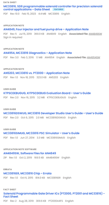

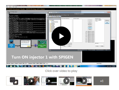

Hello Robert,
could you please share more information? I presume you are using our MC33816 Developer Studio IDE right? Are you using one of our EVBs? KIT33816AEEVM or KIT33816FRDMEVM? If you are using your own design please share your schematic with voltage levels and part values. Are you aware of this document? https://www.nxp.com/docs/en/user-guide/MC33816ASM_APPSPUG.pdf
And other documents and videos on the MC33816 product page
