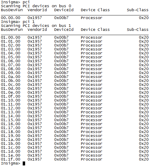

     Now,we are debugging MPC8315E chip based on the environment which is establish by the mirror of MPC8315ERDB_20100727_ltib.iso. In the uboot phase, when the PCIE is initialized,program will read “LTSSM State Status Register”,then return the value 0,which means "Detect quiet".Thus,it can't detect the PCIE device(BCM56134).
The L0 state of PCIE,is configure by hardware or software?IF it need configure,then how to configure?

Now,I input “PCI 1” in SecureCRT , the print message is as follows:
Actually,On physical hardware,PCIe 1 connects with PCI device(BCM56134).
When during scanning pci 1 bus,why It can't detect bcm56134?
In fact,Should be printed like this:
How to set the PCI configuration space, MEM space and  I/O space?
and Which register are need to set?
Such these Macro definitions,how to set ?
CONFIG_SYS_PCIE1_BASE、CONFIG_SYS_PCIE1_MEM_BASE、CONFIG_SYS_PCIE1_MEM_PHYS、CONFIG_SYS_PCIE1_MEM_SIZE?
CONFIG_SYS_PCIE1_CFG_BASE、CONFIG_SYS_PCIE1_CFG_SIZE?
CONFIG_SYS_PCIE1_IO_BASE、CONFIG_SYS_PCIE1_IO_PHYS、CONFIG_SYS_PCIE1_IO_SIZE?

On hardware,we did Cross test. when we push the P1020 core-plate On the button board which has pcie device(bcm56134), the p1020 can detect the bcm56134 by pcie bus.
But,when we push the MPC8315E core-plate on the same button board,the MPC8315E can not find the bcm56134.
The Information is printed as follows:
P1020:u-boot-2009.11;
MPC8315E:u-boot-2009.03-rc2;
In addition to the MEM_BASE、CFG_BASE、IO_BASE,which parameters need to be set。And how to  initialize the pcie??
