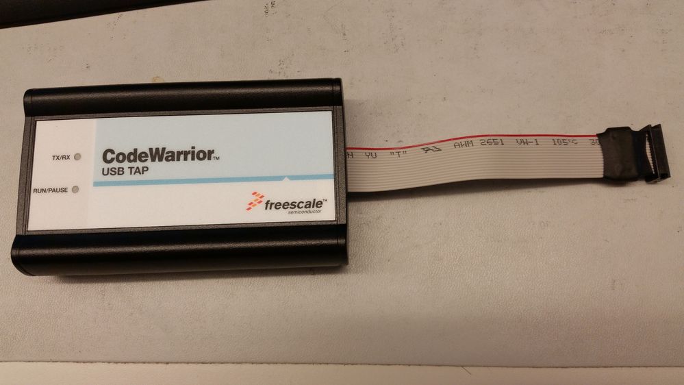

I'm looking at my USB TAP (CWH-UTP-PPCC-HE) and is confused by the Pins of the connector. The red signal of the ribbon is the first one on the upper side. Does that denote Pin 1? I'm asking because I can't find the user manual for it. The only one I found is CodeWarrior USB TAP Probe, which has the red signal as the last one on the lower side of the ribbon.
Btw, where can I download the driver for CWH-UTP-PPCC-HE?

Red stipe denotes Pin 1 of the COP connector.
The USBTAP driver is provided with CodeWarrior and it is typically installed during CW setup.
You can remove/reinstall it following instruction at \CW PA V8.8\ccs\drivers\usb\resdme.txt
