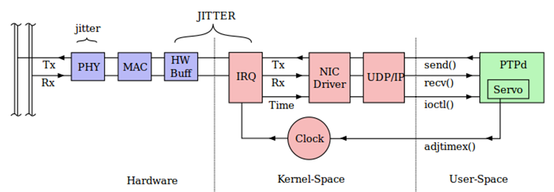

I am trying hw timestamping using timestamping.c (basically sending - receiving ptp packets) on p3041. I added PTP_ENBL_TXTS_IOCTL and PTP_GET_TIME ioctls in the given code. I set clock source as mac clk. I saw counter is incrementing (PTP_GET_TIME ) at user space application. When I send UDP packets (sendpacket), wireshark capturing ptp packets but timestamps always zero. (port: 319)

Please refer to Open Source Software Block Diagram as the following.
Timestamp Processing in Open Source
•A shared time stamp structure – struct skb_shared_hwtstamps.
       struct  skb_shared_hwtstamps {
                            ktime_t hwtstamp;
                            ktime_t syststamp; /* hwtstamp transformed to system time base */
•Time stamps for received packets was stored in the skb. Get a pointer to the shared time stamp structure by calling skb_hwtstamps(). Then set the time stamps in the structure skb_shared_hwtstamps.
•For outgoing packets, skb_hwtstamp_tx() clones the original skb and adds the timestamp to structure skb_shared_hwtstamps. The cloned skb with the send timestamp attached is looped back to the socket's error queue.
•PTPd get the RX timestamp by calling recvmsg() and the TX timestamp by calling recvmsg(flags=MSG_ERRQUEUE).

When I send ptp packet (followup or sync) at User Space App, do I have to add timestamp inside of ptp packet or controller automatically add timestamp outgoing packets?.
I can succesfuly read my loop back timestamp with recvmsg(MSG_ERRQUEUE) from transmitter side but receiver side not getting timestamp when it receives ptp packet.

Please enable 1588 driver for PTPd stack
Device Drivers --->
  PTP clock support --->
     <*> Freescale DPAA as PTP clock
7,300 Views
