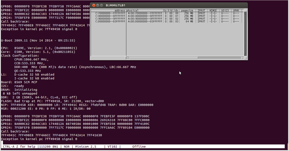

Now when I boot the board I get the following:
U-Boot 2009.11 (Oct 26 2014 - 12:58:32)
CPU:   8569E, Version: 2.1, (0x80880021)
Core:  E500, Version: 5.1, (0x80211051)
Clock Configuration:
       CPU0:1066.667 MHz,
       CCB:533.333 MHz,
       DDR:400  MHz (800 MT/s data rate) (Asynchronous), LBC:66.667 MHz
       QE:533.333 MHz
L1:    D-cache 32 kB enabled
       I-cache 32 kB enabled
Board: 8569 SCM MCP
I2C:   ready
DRAM:  Initializing
0 kB left unmapped
DDR:  2 GB (DDR3, 64-bit, CL=6, ECC off)
FLASH: Bad trap at PC: 7ff49458, SR: 21200, vector=d00
NIP: 7FF49458 XER: 20000000 LR: 7FF4941C REGS: 7febfd48 TRAP: 0d00 DAR: E0000000
MSR: 00021200 EE: 0 PR: 0 FP: 0 ME: 1 IR/DR: 00
GPR00: 000000F0 7FEBFE38 7FEBFF58 7FFC4230 000000F0 7FEBFE3F 000000F0 00000000
GPR08: 7FEBFE2C 000000F0 00000000 E0000000 00000006 2692A314 7FF88C00 7FFC0000
GPR16: 8A000422 8946C19B 1704812A 88700586 00001000 7FEBFD38 00000000 7FF4109C
GPR24: 7FEBFEF0 E0000000 7FF7517C E0000000 00000000 7FFC4230 7FF89104 E0000000
Call backtrace:
7FF4941C 7FF498E8 7FF4A6CC 7FF4ADC4 7FF42A14 7FF41630
Exception in kernel pc 7ff49458 signal 0
What am I missing here?

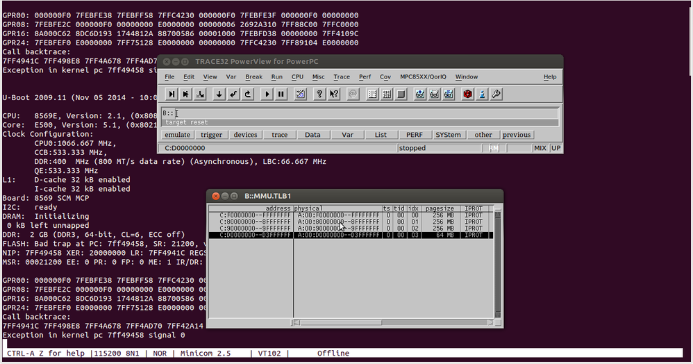

The Following image shows the dump of tlb after crash !!
Can you help me understand what is the role of this tlb entry in tlb.c. Additionally I didn't quite understand the 'epn' and 'rpn' argumnets from description in "E500_core_rm.pdf". Can you explain that a bit.
Thanks in advance.

I knew that it was a TLB miss because of "vector=d00", which corresponds to "STD_EXCEPTION(0x0d00, DataTLBError, UnknownException)" in arch/powerpc/cpu/mpc85xx/start.S.
Your problem is that you're using the same ESEL (entry select) for both entries, so the second entry will overwrite the first, and you will have no mapping for the first half of flash.  You need to pick an unused ESEL for the second entry.

Hi Scott,
Great Information @Scott. I think I tried a different esel too. I have rechecked by using esel as 1 in the second TLB entry , the one for the higher flash.
This is what I have used:
SET_TLB_ENTRY(1/*_tlb*/, CONFIG_SYS_FLASH_BASE/*epn*/, CONFIG_SYS_FLASH_BASE/*rpn*/,
                      MAS3_SX|MAS3_SW|MAS3_SR/*perms*/, MAS2_I|MAS2_G/*wimge*/,
                      0/*ts*/, 0/*esel*/, BOOKE_PAGESZ_256M/*_sz*/, 1/*iprot*/),
    SET_TLB_ENTRY(1/*_tlb*/, CONFIG_SYS_FLASH_BASE2/*epn*/, CONFIG_SYS_FLASH_BASE2/*rpn*/,
                      0/*ts*/, 1/*esel*/, BOOKE_PAGESZ_256M/*_sz*/, 1/*iprot*/),
The error remained totally the same.

scottwood
Could you please paste it in case it's not 100% identical, and double check that you're running the modified code?  Also, that tlb.c can't be the whole file because it ends without closing the array.
Could you use a debugger to dump the TLB1 contents after the crash?

#define CONFIG_SYS_FLASH_BASE           0xE0000000 //CS1    /* First flash bank , start of FLASH 256MB */
#define CONFIG_SYS_FLASH_BASE2          0xF0000000 //CS0     /* Second flash bank of 256MB */
#define CONFIG_SYS_FLASH_BASE_PHYS      CONFIG_SYS_FLASH_BASE
#define CONFIG_SYS_FLASH_BANKS_LIST {CONFIG_SYS_FLASH_BASE2, CONFIG_SYS_FLASH_BASE}
#define CONFIG_SYS_CPLD_BASE 0xD0120000 /* Base addres for CPLD, FPGA, RTC etc devices */
/*Chip select 0 - Flash 2*/
#define CONFIG_FLASH_BR_PRELIM 0xF0001011 //RAJEEV 0xF0001011
#define CONFIG_FLASH_OR_PRELIM 0xF0006FF7
/*Chip select 1 - Flash 1*/
#define CONFIG_FLASH_BR1_PRELIM 0xE0001011 //RAJEEV
#define CONFIG_FLASH_OR1_PRELIM 0xF0006FF7
/* Chip Select 4 - CPLD */
#define CONFIG_SYS_BR4_PRELIM 0xD0120811
#define CONFIG_SYS_OR4_PRELIM 0xFFFFEFF7
#define CONFIG_SYS_FLASH_QUIET_TEST
#define CONFIG_FLASH_SHOW_PROGRESS 45  /* count down from 45/5: 9..1 */
#define CONFIG_SYS_MAX_FLASH_BANKS 2 //RAJEEV changed from 2 /* number of banks */
#define CONFIG_SYS_MAX_FLASH_SECT 2048 //RAJEEV Changed from 1024 /* sectors per device */

And the Snapshot of TLB1 from lauterback debugger after crash occurs is attached.dump.png
7,017件の閲覧回数
scottwood
The TLB entry for CONFIG_SYS_PCIE1_MEM_VIRT is using ESEL1 and overwriting the entry that maps flash (sorry for not noticing this in what you had posted before).  You swapped "FLASH_BASE" with "FLASH_BASE2" relative to the code snippet you posted earlier, which is why the faulting address is still 0xe0000000 and not somewhere in the second half.
7,017件の閲覧回数
manavdeep
Hi Scott,
Yeah I noticed it too later !! I corrected It.
Now I am gonna show you two configurations. This should really narrow down. Please hold on a little more with me.
1. The one where CCSRBAR is relocated (from 0xE0000000 to 0xD0000000) and I am using only CS0. (Its working fine)
2. The one where CCSRBAR is relocated (from 0xE0000000 to 0xD0000000) and I am using both flash banks. (Uboot not running at all)

#define CONFIG_SYS_FLASH_BASE          0xF0000000 //CS0     /* Second flash bank of 256MB */
#define CONFIG_FLASH_BR_PRELIM 0xF0001011 // 0xF0001011
#define CONFIG_SYS_MAX_FLASH_BANKS 1 // changed from 2 /* number of banks */
#define CONFIG_SYS_MAX_FLASH_SECT 2048 // Changed from 1024 /* sectors per device */
#undef CONFIG_SYS_FLASH_CHECKSUM
#define CONFIG_SYS_FLASH_ERASE_TOUT 60000 /* Flash Erase Timeout (ms) */
#define CONFIG_SYS_FLASH_WRITE_TOUT 500 /* Flash Write Timeout (ms) */

#define CONFIG_SYS_BR3_PRELIM CONFIG_FLASH_BR_PRELIM /* NOR Base Address */
#define CONFIG_SYS_OR3_PRELIM CONFIG_FLASH_OR_PRELIM /* NOR Options */
#else
#define CONFIG_SYS_BR0_PRELIM CONFIG_FLASH_BR_PRELIM /* NOR Base Address */
#define CONFIG_SYS_OR0_PRELIM CONFIG_FLASH_OR_PRELIM /* NOR Options */
//MURMU#define CONFIG_SYS_BR3_PRELIM CONFIG_NAND_BR_PRELIM /* NAND Base Address */
//MURMU#define CONFIG_SYS_OR3_PRELIM CONFIG_NAND_OR_PRELIM /* NAND Options */
#endif
//#define CONFIG_FLASH_BR1_PRELIM 0xE0001011 //
//#define CONFIG_FLASH_OR1_PRELIM 0xF0006FF7
#define CONFIG_SYS_MAX_FLASH_BANKS 2 // changed from 2 /* number of banks */

FIRST CONFIGURATION TLB LOG:  uboot_ccsrbar_relocated_but_using_only_cs0.png
SECOND CONFIGURATION TLB LOG: uboot_ccsrbar_relocated_using_both_cs.png
PS: In second configuration, the log you see on serial prompt is from previous run, In current run, there is no output at all on the serial prompt.
Is the it related to reset vector location, how should I proceed?

You could try switching the ESEL used for the two flash banks, though I'm not sure why the entry that maps U-Boot's code would need to be ESEL0 (at the time the new TLB entries are written, U-Boot should be executing out of ESEL15).
You could also try bisecting the location of the hang, by inserting hangs at various points and using JTAG to see whether the system has reached the artifical hang before hitting the real hang.
What are the current values for PC, LR, SRR0, and SRR1 in the hung case, according to JTAG?  Can you correlate the first three to locations in the U-Boot source?
The reset vector location is the same in both scenarios.
Could you confirm that in the 512M-flash scenario, that you're writing U-Boot to the end of the chip that is mapped at 0xf0000000 (and that that chip is connected to CS0), and not the chip that's mapped at 0xe0000000?  Why does the config file you posted for the second scenario have CONFIG_FLASH_BR/OR1_PRELIM commented out?

manavdeep
Thanks @catalin
I was able to figure that out from the manual itself but how do we decide what their values would be. Like in the working example of mine the value of EPN and RPN is CONFIG_SYS_FLASH_BASE right, which is 0xf0000000. Now what "does that mean"? Where is the mapping?
7,018件の閲覧回数
catalindemergia
The processor works with virtual addresses (epn+offset), and according to the mappings in the TLB cache it will actually access the
memory at the physical address (rpn+same offset). The physical address should correspond to your system's memory map. The virtual
address doesn't really matter, it will be translated to the physical one, but I see in your case they are the same.

manavdeep
Hi @catalin
Thanks for the reply, "The physical address should correspond to your system's memory map", Okay, got it. "The virtual address doesn't really matter, it will be translated to the physical one", just one querry, Is it the MMU that gonna do it?
Second thing is that If there is a TLB miss, won't the processor just do what I read back in textbooks, i.e. walk through the page table entries. The fact that I am getting this exception, does it indicate anything otherwise?
I know I might sound naive, but I am really a beginner. So excuse me If i am asking something silly.
7,018件の閲覧回数
catalindemergia
The textbooks are right, when a TLB miss happens it will perform those page table lookups,
but those tables (one per process, or just one table if inverted TLB is used, depending on how the
OS manages MMU) are maintained by the OS. Problem is we are at boot stage now, the OS is not
loaded yet. You have to have TLB entry in the cache, otherwise you will get an exception.
