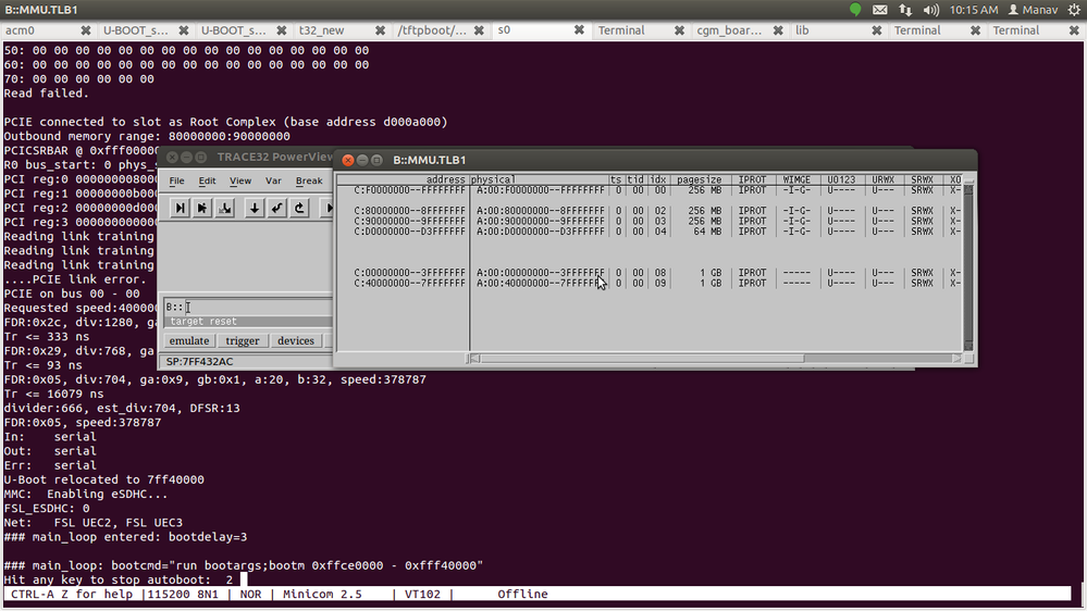

The error dump I showed above comes when the tlb.c has:
    SET_TLB_ENTRY(1/*_tlb*/, CONFIG_SYS_FLASH_BASE/*epn*/, CONFIG_SYS_FLASH_BASE/*rpn*/,
                      MAS3_SX|MAS3_SW|MAS3_SR/*perms*/, MAS2_I|MAS2_G/*wimge*/,
                      0/*ts*/, 0/*esel*/, BOOKE_PAGESZ_256M/*_sz*/, 1/*iprot*/),
    SET_TLB_ENTRY(1/*_tlb*/, CONFIG_SYS_FLASH_BASE2/*epn*/, CONFIG_SYS_FLASH_BASE2/*rpn*/,
and rest 2 files are as in the original post.
The Following image shows the dump of tlb after crash !!
Can you help me understand what is the role of this tlb entry in tlb.c. Additionally I didn't quite understand the 'epn' and 'rpn' argumnets from description in "E500_core_rm.pdf". Can you explain that a bit.
Thanks in advance.

I knew that it was a TLB miss because of "vector=d00", which corresponds to "STD_EXCEPTION(0x0d00, DataTLBError, UnknownException)" in arch/powerpc/cpu/mpc85xx/start.S.
Your problem is that you're using the same ESEL (entry select) for both entries, so the second entry will overwrite the first, and you will have no mapping for the first half of flash.  You need to pick an unused ESEL for the second entry.
10,163 Views
manavdeep
Hi Scott,
Great Information @Scott. I think I tried a different esel too. I have rechecked by using esel as 1 in the second TLB entry , the one for the higher flash.
This is what I have used:
                      0/*ts*/, 1/*esel*/, BOOKE_PAGESZ_256M/*_sz*/, 1/*iprot*/),
The error remained totally the same.

Could you please paste it in case it's not 100% identical, and double check that you're running the modified code?  Also, that tlb.c can't be the whole file because it ends without closing the array.
Could you use a debugger to dump the TLB1 contents after the crash?

And the Snapshot of TLB1 from lauterback debugger after crash occurs is attached.dump.png
10,162 Views
scottwood
The TLB entry for CONFIG_SYS_PCIE1_MEM_VIRT is using ESEL1 and overwriting the entry that maps flash (sorry for not noticing this in what you had posted before).  You swapped "FLASH_BASE" with "FLASH_BASE2" relative to the code snippet you posted earlier, which is why the faulting address is still 0xe0000000 and not somewhere in the second half.
10,162 Views
manavdeep
Hi Scott,
Yeah I noticed it too later !! I corrected It.
Now I am gonna show you two configurations. This should really narrow down. Please hold on a little more with me.
1. The one where CCSRBAR is relocated (from 0xE0000000 to 0xD0000000) and I am using only CS0. (Its working fine)
2. The one where CCSRBAR is relocated (from 0xE0000000 to 0xD0000000) and I am using both flash banks. (Uboot not running at all)

FIRST CONFIGURATION TLB LOG:  uboot_ccsrbar_relocated_but_using_only_cs0.png
SECOND CONFIGURATION TLB LOG: uboot_ccsrbar_relocated_using_both_cs.png
PS: In second configuration, the log you see on serial prompt is from previous run, In current run, there is no output at all on the serial prompt.
Is the it related to reset vector location, how should I proceed?

You could try switching the ESEL used for the two flash banks, though I'm not sure why the entry that maps U-Boot's code would need to be ESEL0 (at the time the new TLB entries are written, U-Boot should be executing out of ESEL15).
You could also try bisecting the location of the hang, by inserting hangs at various points and using JTAG to see whether the system has reached the artifical hang before hitting the real hang.
What are the current values for PC, LR, SRR0, and SRR1 in the hung case, according to JTAG?  Can you correlate the first three to locations in the U-Boot source?
The reset vector location is the same in both scenarios.
Could you confirm that in the 512M-flash scenario, that you're writing U-Boot to the end of the chip that is mapped at 0xf0000000 (and that that chip is connected to CS0), and not the chip that's mapped at 0xe0000000?  Why does the config file you posted for the second scenario have CONFIG_FLASH_BR/OR1_PRELIM commented out?

manavdeep
Hi Scott,
Thanks for the reply.
1. Below is the .cmm file I am using to flash u-boot.
So yeah I am using the correct flash (CS0) and flashing the Uboot at the end of the same from address 0xfff80000 onwards.
; Programming LOCAL BUS CONTROLLER registers.
Data.Set ANC:iobase()+0x05000 %long 0xF0001011 ;LBC_BR0 ;Flash 0
Data.Set ANC:iobase()+0x05004 %long 0xF0006FF7 ;LBC_OR0
Data.Set ANC:iobase()+0x05008 %long 0xE0001011 ;LBC_BR1 ;Flash 1
Data.Set ANC:iobase()+0x0500c %long 0xF0006FF7 ;LBC_OR1
//other stuff here
Flash.Program 0xFFF80000--0XFFFFFFFF
DATA.LOAD.BINARY   fsl_qe_ucode_8569_20.bin 0xFFF00000 /word
DATA.LOAD.BINARY   u-boot.bin 0xFFF80000 /word
2. The CONFIG_FLASH_BR/OR1_PRELIM should not have been commented in second configuration. My mistake.
I corrected the code. I also tried switching esel value for tlb entries of the flash but no luck.
3. I know the values of PC, LR and SRR0 from JTAG GUI, but I am not aware how I would relate it to the Uboot source. :smileyconfused: Enlighten me. :smileyhappy:
Manavdeep Singh
Research Engineer , Cdot-delhi
contact no: 09971350079
10,163 Views
scottwood
Looking up U-Boot addresses is a bit trickier than kernel addresses since U-Boot jumps around a bit, but if you subtract from the address the place where you expect the start of the U-Boot image to currently be (in this case, it should be 0xfff80000 if you're using a U-Boot version that produces a 512K image -- what U-Boot version are you using?), and then add that to the address of the _start symbol, you should get the address from the ELF file's perspective.  Then you can use a PPC-targeted GDB on the u-boot ELF file to look up the asm code (with "disas 0x<address>") and/or source line ("i li *0x<address>" or "li *0x<address>")
10,163 Views
catalindemergia
I can clarify the "epn" and "rpn" arguments
epn = effective page number
rpn = real page number
They define the mapping between the effective address and the physical address for the TLB.
regards,
Catalin
10,163 Views
manavdeep
Thanks @catalin
I was able to figure that out from the manual itself but how do we decide what their values would be. Like in the working example of mine the value of EPN and RPN is CONFIG_SYS_FLASH_BASE right, which is 0xf0000000. Now what "does that mean"? Where is the mapping?
10,163 Views
catalindemergia
The processor works with virtual addresses (epn+offset), and according to the mappings in the TLB cache it will actually access the
memory at the physical address (rpn+same offset). The physical address should correspond to your system's memory map. The virtual
address doesn't really matter, it will be translated to the physical one, but I see in your case they are the same.
Let me know if I understood your question right.
regards,
Catalin
10,163 Views
manavdeep
Hi @catalin
Thanks for the reply, "The physical address should correspond to your system's memory map", Okay, got it. "The virtual address doesn't really matter, it will be translated to the physical one", just one querry, Is it the MMU that gonna do it?
Second thing is that If there is a TLB miss, won't the processor just do what I read back in textbooks, i.e. walk through the page table entries. The fact that I am getting this exception, does it indicate anything otherwise?
I know I might sound naive, but I am really a beginner. So excuse me If i am asking something silly.
10,163 Views
catalindemergia
The textbooks are right, when a TLB miss happens it will perform those page table lookups,
but those tables (one per process, or just one table if inverted TLB is used, depending on how the
OS manages MMU) are maintained by the OS. Problem is we are at boot stage now, the OS is not
loaded yet. You have to have TLB entry in the cache, otherwise you will get an exception.
regards,
Catalin
10,163 Views
yipingwang
Hello Manavdeep,
The ORn registers configuration looks abnormal, please refer to "Table 12-5. Reset value of OR0 Register" in the section "12.5.1.2 Option Registers (OR0–OR7)" from http://cache.freescale.com/files/32bit/doc/ref_manual/MPC8569ERM.pdf.
Yiping
