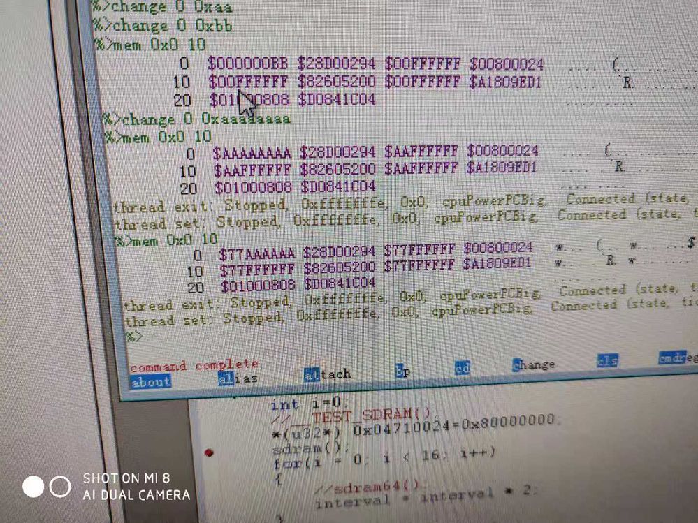

我现在遇到一个问题,SDRAM基地址是0,向0地址写入字节0xaa(或者其他数据),会自动把字节0x8、0x10、0x18地址改成和0xaa一样的值。如图所示,能帮我分析下可能是什么原因吗?板子是参考开发板做的。

I am now experiencing a problem where the SDRAM base address is 0, writing byte 0xaa (or other data) to the 0 address will automatically change the byte 0x8, 0x10, 0x18 address to the same value as 0xaa. As shown in the figure, can you help me analyze what might be the reason? The board is made with reference to the development board.

Do you have one board or more? Would be helpful in case of SDRAM malfunction.
Do you properly initialize the SDRAM?
As per your BR1 setting, SDRAM base address is 0xf0000000. Why do you test the SDRAM at address 0x0?

There is another identical board, and the problem is the same. The address in the figure is the photo when I configured the SDRAM base address to 0xf0000000. The same problem as the SDRAM base address is configured to zero.
5,060 Views
Bulat
If you read a single word at address 0x8 (or 0x10, 0x18), is result the same as you read 10 words at address 0x0?
What about SDRAM initialization? What is the sequence?

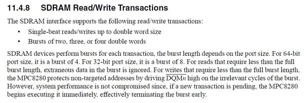

会跟MPC8280针对每次操作都是BURST有关系吗?
