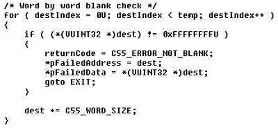

Blank check is implemented by software, there's no support for this in flash controller. It looks like:

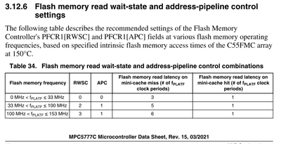

To make it faster, configure max system clock, enable instruction cache and check if you configured wait state as required:
