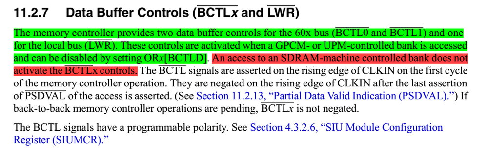

Yes, BCTLx lines are not active for SDRAM. So, it looks like you can not use buffers on data bus.
I can only recommend reducing load per one data bus pin:
1. You said you are using 12 SDRAM chips, each chip has 32-bit wide data port. The data bus at the processor, however, is 64-bits, so the first recommendation is to use full 64-bit bus width, and connect SDRAM devices in pairs to create 64-bit banks. In this case you will have only 6 chips connected to each data line.
2. If this is not enough, I recommend switching to 16-bit (or even 8-bit) SDRAM devices, if possible. For 16-bit SDRAM chips you can place 4 chips in parallel to create on 64-bit memory bank, so 12 chips will create only 3 memory banks, this means you will have only 3 chips connected to each data line.

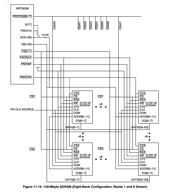

I got your point. We have this option to use 8 bit or 16 bit SDRAM devices but i do not understand how in the MPC8270 Reference manual it is shown that 64 SDRAM chips are attached to processor on 8 banks. This means data is shared on 8 lines. Considering the reference manual we do not have the control of SDRAM Data buffer so how this diagram will practically be implemented?
Fig : Pg 454 of Reference Manual 8270.
Document Pg # 11-34

There is no data buffer on this figure, and the fact that 8 chips are used in parallel - does not mean data buffer should be used. The necessity of data buffer comes from total capacitance, output impedance and required speed (bus frequency).
