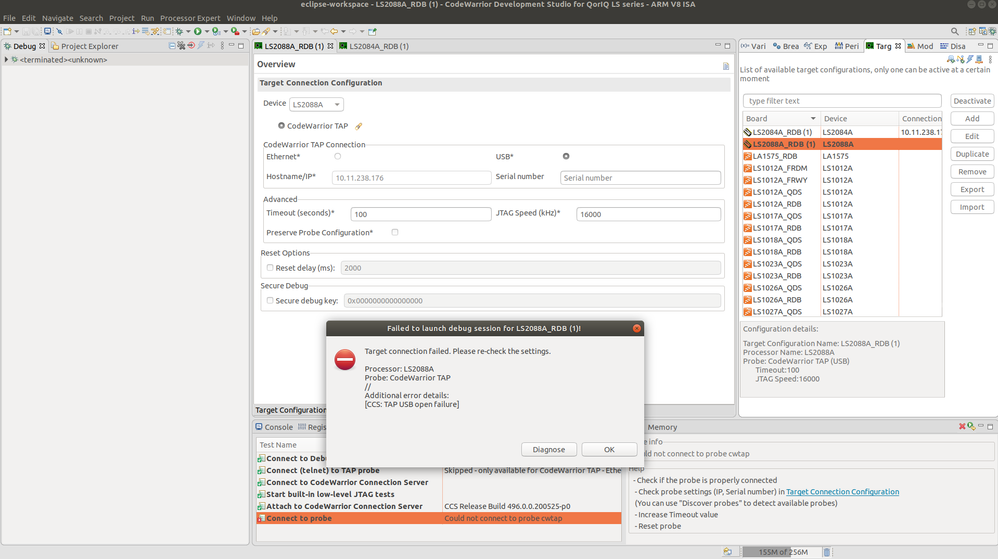

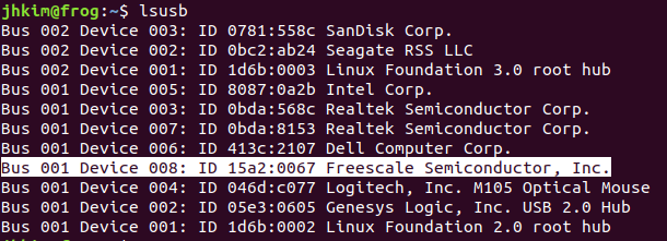

I can connect CW TAP with ethernet, but cannot connect it with USB.
OS detects the CW TAP, but codewarrior software cannot access to CW TAP with USB.
I'm using CodeWarrior Development Studio for QorIQ LS series - ARM V8 ISA Linux version.
Here is usb list of my PC and error screen of Codewarrior software

Please refer to the file Freescale/CW4NET_<version>/Common/CCS/drivers/usb/readme.cwtap.txt to install udev rules and make them take effect.
