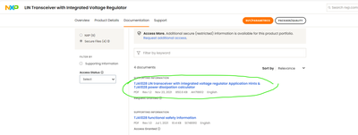

[gw] TJA1028 | LIN Transceiver with Integrated Voltage Regulator | NXP Semiconductors
You can download this power dissipation calculator for getting more info.
