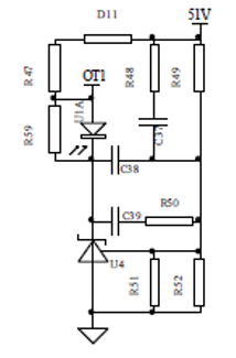

Hello - attached is the schematic and BOM from the vendor. Our specs are 51v and 1.9 amps, we wanted also a cutoff at 2.1 amps - but this design does not cut off until 2.4 amps.   We did not audit this design because this company supplied 1 million units of a different design without issues ( and we are not experts anyway!).    The 7N65 Mosfets they used were either the CS7N65 or the SIF7N65, some of the dead supplies show severe stress on those SMD MOSFETs ( they are DPACK not TO220).  The input bridge ( type 406)  is surprisingly hot in our FLIR images.  They used a 20 amp 150v TO-220 schottky with 10uA leakage on the output.   As mentioned in the OP, 7% have failed soon after installation.   A sample power supply with a direct short on the output does not fail after 6 hours.   We know that at least 2 of the failed units were operating at 96 watts for days before failing.
Out of the box new power supplies use 110 watts to product 96 watts out.  This is a lot worse than the 93% in the data sheet.
Replacing the SIF7N65 with an STM STD7N65M2 does not improve efficiency.   The PFC FET is a IPS ITA20N50A - the 2SK3568 in your reference design is no longer available.   While the use of SMD instead of TO-220 on the 7N65 will be a reliability issue, unless we can increase the efficiency from 86% to 93%, just going to a TO-220 isn't a solution.
You ideas are most welcome.

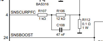

Hello Murray,
I have checked your schematic and compared it to a TEA1716DB1255 board. Please refer to Figure 14. in UM10557. The C7 in your schematic shouldn't be there. The resistor R29 should be connected directly to the SNSCURHBC pin 17.
In your schematic the C23 is connected to the SNSCURHBC pin 17.

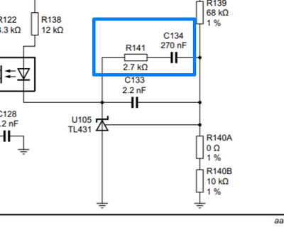

Thanks for this answer.   We will compare all the parts and do some testing.   I notice that the App Note does not mention the need for a snubber on the secondary Schottky - any reason to not need that in your design?

do you mean the Schottky diode U4 in your schematic and U105 in the Figure 14. in the UM10557? There is a snubber. R141 and C134.
I added the values from BOM to the schematic. Please find the schematic attached for your convenience.

U4 / U105 is a TLV  - not a schottky - don't you agree?
It is Schottky Q5 in our schematic that has the snubber added by the CM, I think this is recommended by ST in their AN1453 application note.    Is it not needed with the reference design 60v MBR2060?

yes, you are right. The U4/U105 is a TLV. You mean the rectifier diodes. You can add a snubber to the rectifier diodes, but there is always a trade-off between using it and not using it. If the snubber is required in your application due to sudden interruption of current flow from the load, which will cause sharp rise in voltage, you can use the snubber to eliminate the transient voltages. But this will decrease the efficiency of the SMPS, because some current will be turned to heat in the snubber's resistor. So using snubber depends on requirements. Please consider above before using the snubber.
