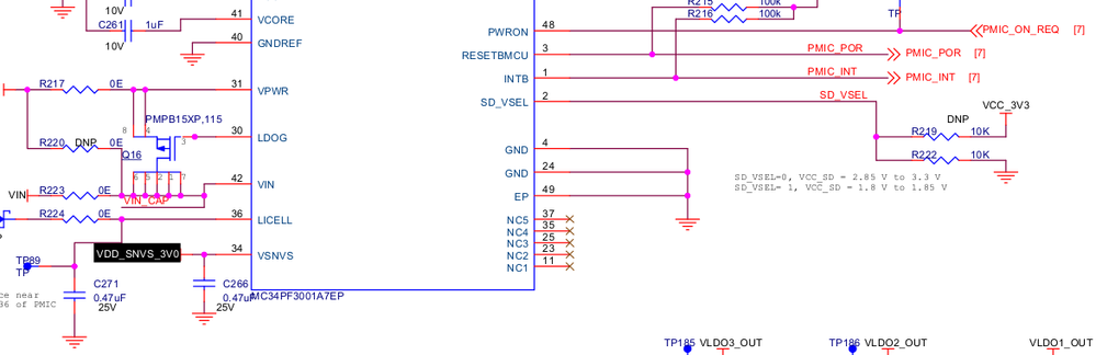

guoweisun
HI
You should pull up this pin to VSNVS or other high level,if PWRON is low PMIC will stay OFF.

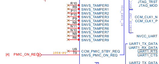

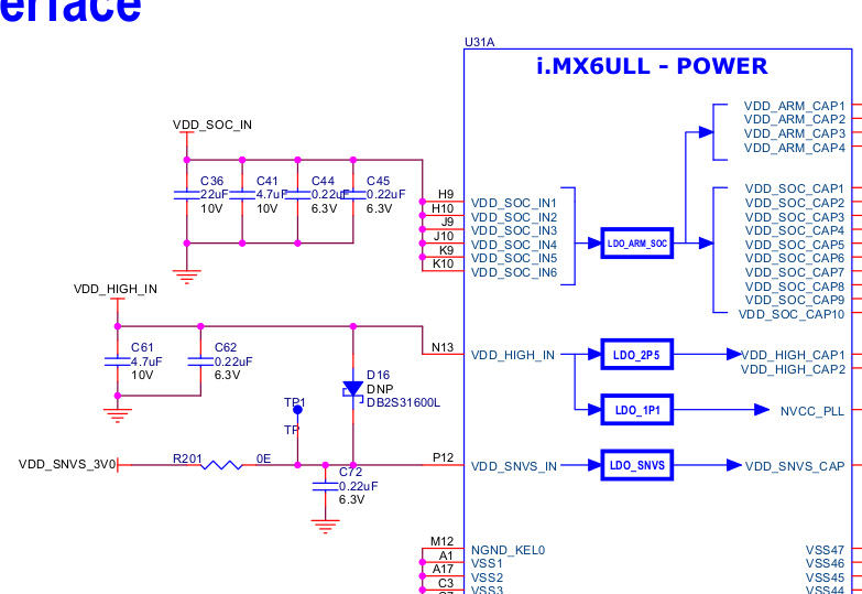

vivekrajpara
Hi guoweisun ,
I am taking this case further on behalf of [email protected] .
Issue:
As discussed earlier, we are not able to recover automatically after thermal protection event and we need to manually power on the system everytime, which is the major blockage for us.
Observation:
Based on our observations, SNVS supply is giving proper voltage in thermal protection state and rest of the supply are in OFF, so the processor is not in ON state. Here we are waiting for pmic to go below threshold and restart the processor again, however it is not happening.
Workaround:
If we connect the "PWRON" pin with external pull-up or SNVS supply, then the PMIC recovers automatically after going below thermal protection threshold and restarts the processor.
1) Is it necessary to connect the "PWRON" to external pull-up?
2) If yes, then can we have such information located in datasheet? Any recommended pin configuration for thermal protection recovery?
I have attached the below screenshot showcasing our current schematic design of PMIC with i,MX6ULL.
Waiting for your helping response.
