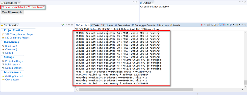

During the time I test the fucntion of SBC(FS4500)and S32K144, before I disconnected the reset pin of SBC and MCU to debug. When I recover the connected of the reset pin of SBC and MCU, use debuger to reprogram, the program can't run meanwhile the period nobody to feed the watchdog caused the reset pin asserts always. I want to know if there will damage S32K144 when the reset pin always asserts low.

Thanks for your kindly response, I should describe the reset conditions more detailedly. The reset pin of S32K144 is low every 256ms, and duration time is 8ms, I'd like to knwo whether will it influence the reprograming when using Jlink to debug? The fact is that when I do this, It  seems damaged the S32K chip so that I can't read the register.

Thanks for clarifying. Regarding your question, yes, it will influence the reprogramming when using any debugger, not just with JLink. Any debugger that you use must have total control over the reset line at the time of programming/debugging.
