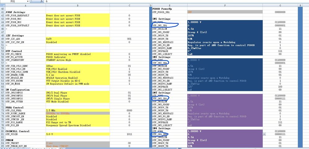

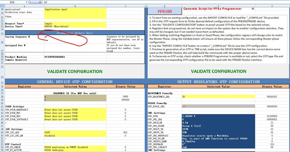

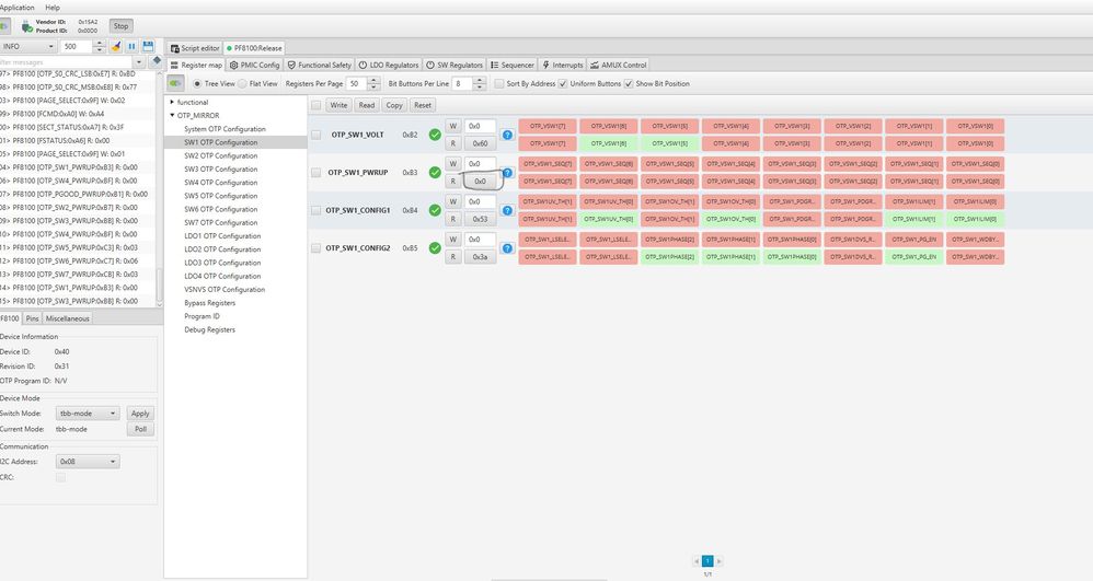

  I setup a configured file with OTP request form for MC33PF8100EQES,i read value of register OTP_SWx_PWRUP out ,they showed 0x00,that means voltage regulators did not work,so no expected voltage output,more detail see belowings
form_otp.jpgform_otp.jpgform1_otp.jpgform1_otp.jpggenerator.jpggenerator.jpgotp_read.jpgotp_read.jpgotp_read1.jpgotp_read1.jpgotp_read2.jpgotp_read2.jpg

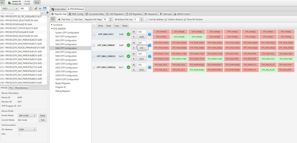

generator.jpggenerator.jpgflex-gui.jpgflex-gui.jpgHi Mr Zhang:
 I read function register with flex-gui,i did not find version of PF8100,detail as following:
 1,register 0x00,its value is 0x40
 2,register 0x01,its value is 0x31,so what version of 8100 it should be ? it is not A0 or B0
also i need to know how i can modify correspond version in configured excel in package flex-gui

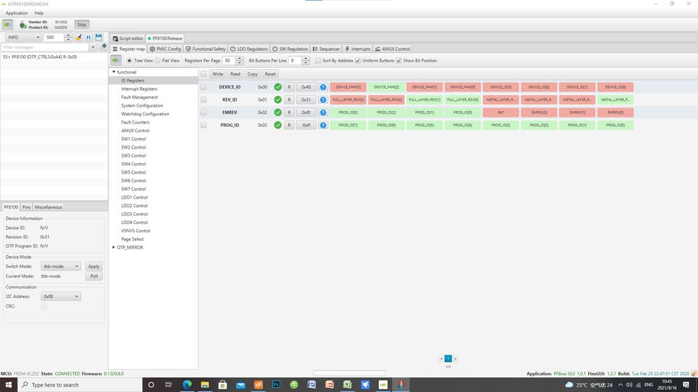

Sam1978
Hi Mr Zhang:
 Would you like to post download link of latest flexGUI?
 it seems that mine (showed pictures of flexGUI) are latest
