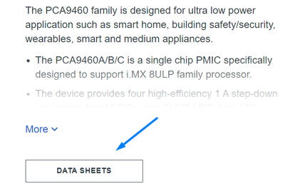

JozefKozon
Dear Shai,
the PCA9460 is indeed suitable for your customer's application. Buck1 is by default 1.8V and all Buck and LDO regulators are ON by default.
JozefKozon_0-1634017212392.pngJozefKozon_0-1634017212392.pngJozefKozon_1-1634017251166.pngJozefKozon_1-1634017251166.png
The PCA9460 datasheet is confidential and I am not allowed to share it here. Please create a ticket here and me or one of my colleague will share the PCA9460 with you. Or please download the datasheet from this link
