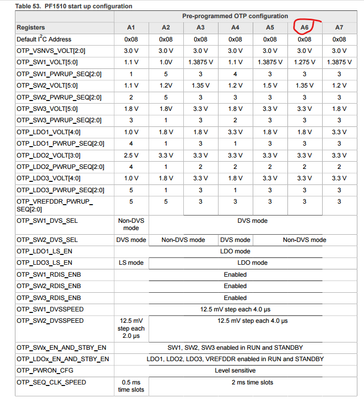

We are using the PMIC MPN MC32PF1510A6EP with a MCIMX6Y2DVM05AB (i.MX6ULL) part.
For this we don't see any reference schematics or documentation that can help us understand which power rail on the PMIC is to be connected to the respective power rails on the processor / peripherals.
The only reference is the Example schematic on the datasheet, but that is not applicable to the i.MX6ULL. The EVK schematic is similarly not helpful for this purpose.
Please help with any references available for the same and also the voltage configuration and power sequencing for the MC32PF1510A6EP part.

Here I post the PF1510 A6 power tree detail info:
You can see A6 OTP configuration detail!
Thanks!
