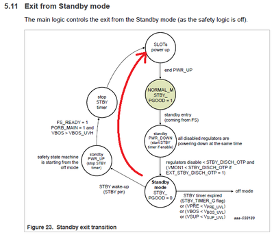

I am using KITVR5510DA0EVM to test the Standby mode transition function.
When I tried to exit the Standby mode by "STBY pin = Low", VR5510 did not re-enter the Normal_M mode as expected, but a reset occurred. It looks as if the PGOOD and RSTB could not be released due to the VCOREMON_OV occurrence, making 8sTimer time out, thus entering Deep-FS and causing reset.
Is there any wrong I have do or any step I have miss?
operation is as follows:
  1. Load and run the test script according to UM11587-8.1 Operating in debug mode;
  2. Disable M_SM_CTRL1[STBY_TIMER_EN];
  3. Entry Standby Mode: Set STBY pin = High;
  4. Check STBY_PG=Low;
  5. Exit Standby Mode: Set STBY pin = Low.

Q1:I refer to Figure 23 of AN12880 to verify the exit Standby. I disable M_SM_CTRL1[STBY_TIMER_EN].
In this case, the STBY timer should not expire, right?
A1: Correct.
Q2: Do I need to load the fuses again with the requested data after I exit the Standby mode by STBY wake up (STBY pin) command?
A2: Customer needs to program(burn) OTP to a VR5510 part to try the standby entry and exit functions but not using the TBB mode. If they use a programmed part, the device will automatically load burned OTP when it exits standby mode.

please see below answers from an application engineer I have contacted.
DESCRIPTION
A1: Correct.
With Best Regards,
Jozef
