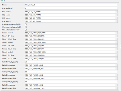

 In our project, HSx is configured to drive LED lights, with four HS outputs, selecting PWM1, PWM2, PWM3, and PWM3 sources, at a frequency of 200 Hz. During debugging, we found that the interface Sbc_fs23_SetHSxSource() cannot control the corresponding channel's on and off ; instead, we need to use the interface Sbc_fs23_SetTimerPwm() to control them. Below is the configuration of the High side driver:
Additionally, read the configuration registers again , FS0B and LIMP pin levels high, everything is normal. I would like to ask if this control method is correct.
Thanks!
