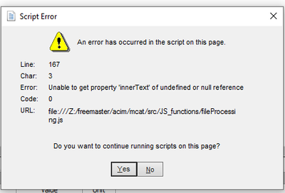

Tried to power up the motor with FreeMASTER 3.2 - running under Virtualbox Windows VM
using an old (2017) copy of
acim_ref_sol.pmp.  It connected correctly at 19,200 baud  but with a lot of non-javascript 'missing freemaster variables errors',
but it would spin the motor.  I couldn't complete the motor tests because of the missing variables. It would just report crazy negative estimated speeds.
Now, I tried instead the  same  acim.pmp  which came with the above SDK.
Even though it does connect over UART at 19200, it doesnt run at all because
I just get the following error, and the GUI is not operational
--- See attachment for image of error
Is there a newer version of ACIM or anything else I can try.
Strangely,  even the old   acim_ref_sol.pmp   which used to  kind-of run,
now reports these same javascript errors as in the attachment.

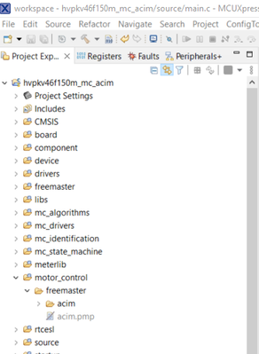

Sorry, what version of SDK are you using? Since the SDK for HVP-KV46F (2.8.0) does have the .pmp file in the following path:
On the other hand, I must admit that I am working on Windows and we have not tested anything about this on virtual machines on Linux.
If you still have questions regarding FreeMASTER, I recommend you ask in the FreeMASTER Community where our experts in this tool can help you in more detail.
7,346 Views
johnwood101
yes, I am using HVP-KV46F (2.8.0)
and I reloaded it again, remembering to tick the  freemaster  tickbox, and now found acim.pmp.
However, when I run it, I still see this message:
It looks like the error is to do with Javascript.
( The  old  2017   acim_ref_sol.pmp  which came with
High Voltage Motor Control Platform   software
does not show this error,  so it must me something introduced
between the two version of the  .pmp file. )
Please could you tell me which version of Windows is it that
the acim.pmp   is running on for you?
( the acim.pmp  which comes with HVP-KV46F (2.8.0))

_Leo_
Windows 10
7,246 Views
johnwood101
thanks for your help.  I have it running correctly now on the Windows machine,  but after motor identification,  the control is not stable below 300rpm on a 1500rpm 0.55kW ACIM in sensorless FOC .
