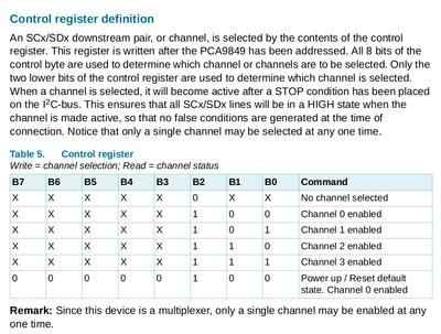

Hi @reyes
I'm using PCA9849 i2c MUX to connect the 2 camera modules to IMX8MP
It automatically detects the channel ID when the device is connected.(say if module is connected to channel 1, control register status returns 0x04 and if module is connected to channel 2, control register status returns 0x05).
Here I'm able to control the channel 1 device by default. But if I have to point the MUX to channel 2, what I have to do?
I have tried to set the control status register to 0x05 using i2c-tools (i2cset -f -y 2 0x71 0x0000 0x05).
But still it is not pointed to channel 2.
Is there anyways to handle it from the mux driver?
Thanks in advance
