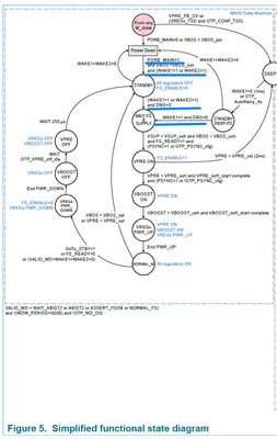

I'm working on a fs8530 prototype and I designed one acording to datasheet, application note and referanced from KITFS85FR. Unfortunately, It didn't work. I atteched schematic.
All the regulator has no proper output.  For vpre I read 0.5volt, 0.5volt from pre_ghs(its not pwm), I couldt read any voltage from pre_gls. For buck2, there isnt output. For buck1, there is 0.55 volt. There is 5.7volt at FS0B(pin 14).

Hello Furkan Berk Kaya,
could you please confirm which part number you are using? In the question you named MC33FS8530A0ES, but in your schematic is MC33FS8510A2ES.
Could you please confirm, that you have set the pins (Wake1, Wake2, DBG...) according to the Main State Machine in the FS84-FS85 datasheet?

Hi Jozef,
I used MC33FS8530A0ES at prototype. Because they are same footprint, I used MC33FS8510A2ES at schematic.
Yes, I confirmed. I tested the coded IC at KITFS85SKTEVM(socket version). It works there properly.

JozefKozon
I apologize for a late reply. I have checked the datasheet and the A0 and G0 parts including the MC33FS8530A0ES are non-programmed OTP configurations. Pre-programmed OTP
configurations (other than BUCK regulators and ASIL level) are managed through part
number extension: A1 to FZ for FS85 and G1 to LZ for FS84.
Have you programmed the MC33FS8530A0ES for the required outputs? Could you test a preprogrammed version, for example MC33FS8530A1ES or MC33FS8530A4ES?

JozefKozon
to enter debug mode, the DBG pin must be held high, connected to the VSUP and the WAKE1 or WAKE2 must be connected to voltage higher, than WAKE12VIH=4V after minimally 7ms, the voltage on the DBG pin has reached the VDBG voltage. Please refer to section 14.5 and Table 8. in the FS84-FS85 datasheet attached. You can also manually enter the debug mode with a circuitry described in section 4 in AN12333 attached.
