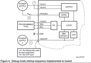

Dear Community,
I would like to read and write OTP register on VR5510.
I tried to enter test mode for this following AN13182 - VR5510 Device Design Guidelines.
When I read the FS_STATES from VR5510, it was DEBUG mode.
So, I  wrote key1, 2, 3 on M_TS_ENTRY and FS_TS_ENTRY sequencially but when I read back M_TS_STATUS1 and FS_STATES register, it was not in test mode.
Does it require special environment or status?
When I read FS_STATES, it was 0x09 = Asserted FS0B.
In this status, VR5510 cannot go into test mode for program OTP?

You are correct, the Debug mode can be confirmed by reading the fail-safe register, FS_STATES(0x18h). If bit DBG_MODE is set to 1, then the Debug mode entry is successful. Could you please confirm that all the regulators are OFF as long as VDDOTP is held high?
Once in debug mode, the next step is to verify that the device is in test mode.
After debug entry, a set of test mode keys must be sent through I2C to enter test mode.
The same set of test mode keys must be written to both the main and fail-safe test mode entry registers - M_TM_ENTRY (0x1Fh) and FS_TM_ENTRY (0x26h). Each of the keys below must be written in succession to each register
– key1: 11010101_10100111
– key2: 10111000_11101110
– key3: 00001111_00110111
After the procedure above, could you please read bit 6 of M_TM_STATUS1 (0x25h) and bit 15 of FS_STATES(0x18h) registers to verify the test mode status?
I know this process is confusing, for further information please review the chapter chapter 5.1 from the application note AN13182.
As a brief, to modify the OTP or to read the existing OTP settings the device must be in debug and test mode.

You are correct, after debug entry, a set of test mode keys (mentioned above) must be sent through I2C to enter test mode using the programming tool.
Note that during debug mode, as long as the VDDOTP pin is held high (>5 V), the regulators will be OFF.

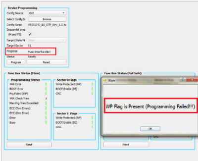

I purchased the toolkit but the VR5510 looks already protected by WP(write protection).
How can I release the Write Protecton on VR5510?
Harry

I purchased the programming kit and tried to program OTP on my VR5510.
But I failed with "WP Flag".
I tried this on VR5510AMDAHES which was already programmed by NXP for S32G/LPDDR4.
Can I change the OTP values to QM?
How can I disagle "write protection".
Harry

What do you mean with WP Flag? Could you please share a screen shot of such flag?

I purchased this toolkit  and I can see the below message on trying to program on VR5510.
It was already programmed to ASIL D but I would like to change to QM grade.
Is there any way to program again? It then, let me know.

I am afraid that you cannot change the programming of the device if you have already programmed it. This is a “One Time Programmable” device, multiple programming is not supported.

When I asked you before about this in same topic, you said it is possible, so I purchased the toolkit.
Cannot I change the WP flag manually?

OTP allows the programming of start-up configurations for a variety of applications. Before permanently programming the IC by programming fuses, a configuration may be prototyped by using the debug mode.
In this case, you are using a programmer. So the internal fuses of the devices get burned.
In regard with such flag, are you trying to program a non-programmed device or it is already programmed?

First of all, I would like to make sure that the device is in debug mode. As we know, the debug mode allows users, via the I2C interface, to access the OTP register set, modify the registers, and test device functions.
The VR5510 enters in Debug mode with the following sequence:
  1. Apply VDDOTP pin > 5 V.
  2. Apply VSUP1/2 > VSUP_UVH and PWRON1 > PWRON1VIH or PWRON2 >PWRON2VIH.
  3. The device now starts in Debug mode, ready for debugging or OTP programming.
  4. Apply VDDOTP = 0 V to turn on the device with the modified configuration.
Are you following the procedure mentioned on the chapter 8.12 from datasheet?

I can confirm that VDDOTP > 5V but I'm not sure VSUP1/2 > VSUP_UVH and PWRON1 > PWRON1VIH or PWRON2 >PWRON2VIH.
But when I read the FS_STATES, the register value tells that VR5510 is in DEBUG_MODE.
Then can I proceed next step to start test mode for OTP programming?
