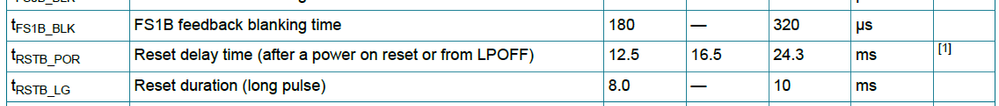

Hi ,
We are using FS6500 in one of our project applications.
Could you please let us know what is the longest worst case time between power up and application availability (CAN controller can receive etc?)
1,616 Views
JozefKozon
Hi Anne,
please refer to section 11.14.3 RSTB pin and to Table 6. tRSTB_POR, where the Reset delay time is maximally 24.3ms.
