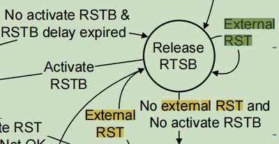

What the "External RST" mean?

TomasVaverka
The RSTB pin acts as as output/input. Its main function is to reset the MCU, but input voltage is monitored in order to detect external reset (external RST) and fault condition.
BRs, Tomas
