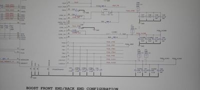

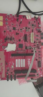

Hello, my FS26 will report TRK2_UV failure at the INIT_FS stage of the chip, so it cannot exit the INIT_FS stage, and the functional safety state machine is stuck. May I ask what is the cause

So for your FS26 setting TRK2_V_OTP [1:0] = 11 as 5.5V and actually it only has 5V,so it trigger UV threshold,right?

It may be so, but the agent did not provide the documents for OTP configuration when buying the board. The model of FS26 is FS26AMDA0A1, and the model of development board is SCH-47651 REV A1

dingyazhou
As explained below, TRK2 and TRK1 are both 5V, now TRK2 will have an undervoltage flag to read the FS_OVUV_REG_STATUS register through SPI

guoweisun
Could you please share with your schematic?
8,404 Views
dingyazhou
8,382 Views
guoweisun
During the initialization phase, you can try to set VMON_TRK2_UV_FS_REACTION [1:0 ] as 00 to disable safety output and RSTB based on register of FS_I_OVUV_SAFE_REACTION2.
Use this method to eliminate the TRK2 UV affect.

guoweisun
Please measure the actual value of TRK2 and check whether the short circuit happened or not?
8,424 Views
dingyazhou
The voltage of TRK2 and TRK1 is 5V, and now it is TRK2 undervoltage fault stuck functional safety state machine. The chip manual has such a sentence:  If the regulator is used as a global pin, outside of the module, it is recommended to not include it in power up sequence and turn on the regulator by SPI, to avoid a stuck in reset condition in case of short circuit.
