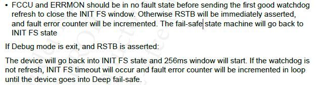

It seems that all what you are doing is correct.
Note that in Debug mode, FS0B is kept low and cannot be released.
Regarding the RSTB, please see below from the AN13850 - NXP FS26 Implementation and Behaviors.
Tomas

Thanks for you reply!
I focused on FCCU and turned off FCCU monitoring (FS_I_SAFE_INPUTS.FCCU_CFG). Problem solved, but I'm not sure why ,because I turned off FCCU related reaction earlier, so it won't affect RSTB and FS0B。
