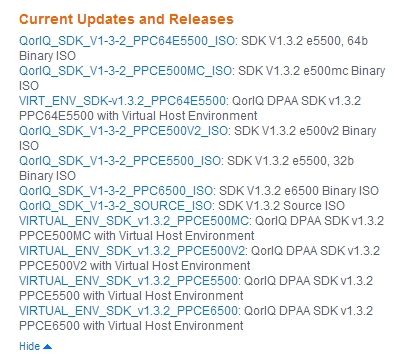

First thing to note is that there is more than one ISO image available.
I already have a Ubuntu lucid machine, that I use as a build machine. So I didn't need the virtual images. I'll need the source file - so I downloaded QorIQ_SDK_V1-3-2_SOURCE_ISO, and I am going to try this on a P3041, so I downloaded the e500mc binary. The binary isn't necessary, but it speeds up the builds significantly.

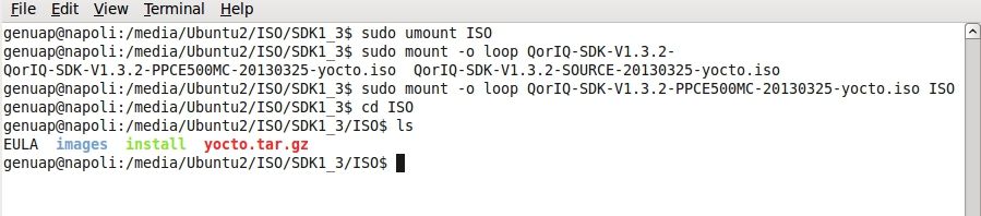

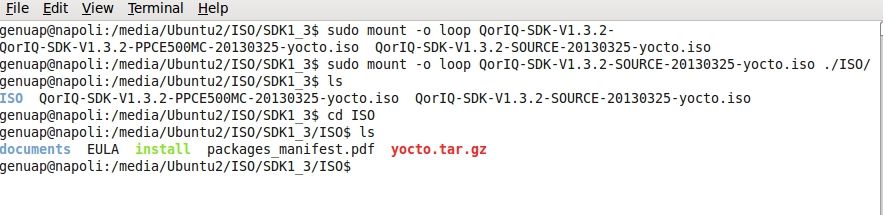

When they've finished downloading, the first thing to do is mount the source ISO
Within the source ISO there's an install script. I run that and let it do it's thing. Important to note that there's documentation contained within the document's directory. If you go to documents/START_HERE.html you will get html based documentation on the SDK. And, if you keep drilling down and go to documents/sdk_documentation/pdf there are some pdf documents for various features. The document QorIQ_SDK_Infocenter.pdf is a complete collection of the SDK documentation taken from the Freescale infocenter site.
Once, the source is install, I do the same for the binary.
Make sure you install the binary on top of the source (i.e. in the same directory).

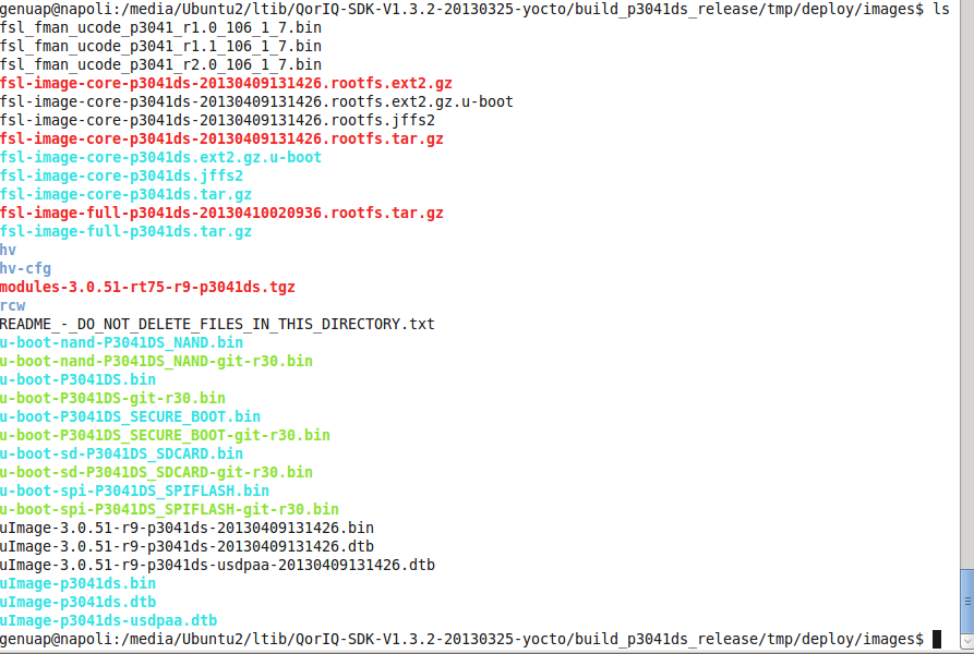

When all is said and done, I can find my images in the build_p3041ds_release/tmp/demply/images directory.
In my case, I have quite a few images because I've actually built the core and full images. Next, I have to grab these images and deploy them to my target.

The SDK binaries are located within the SDK directories. In your case it should be under /../build_T4240_release/tmp/deploy/images/
There should be a bunch of files in there:
     u-boot[...].bin (this is the SDK's version of U-boot)
     uImage[...].bin (this is the linux kernel)
    uImage[..].dtb (this is the device tree which describes the board)
     fsl-image-[full/core/etc...].tar.gz  (this is the root file system)
    fsl_fman_ucode[..].bin (this is microcode to run on the FMAN)
