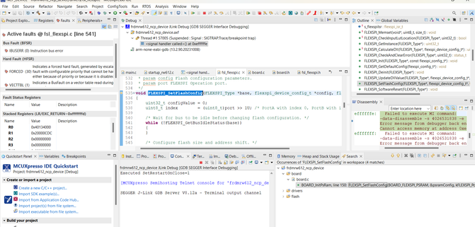

I wanted to run ncp_device example code on FRDM-RW612 board which is not working.
IDE used : MCUXpresso IDE v24.12
SDK used : LOKENDERVASHIST_0-1747890582736.pngLOKENDERVASHIST_0-1747890582736.png
When flashed the code on FRMD-RW612 got a hard fault error as shown below:
Can anyone help me with this issue debugging ?

Hello Shaun ,
Please find attached .axf file
1,027件の閲覧回数
shaun_wu
Hello @LOKENDERVASHIST
Sorry for late reply. It works on my board. Could you try unlock your FRDM board?
Disconnect and connect your board with the ISP button pressed.
Best Regards
Shaun

Hello
Could you share built .axf or .bin file to us?
