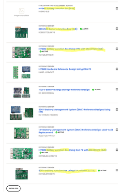

yes, it is possible to use MC33772C for current measurement only, without need to connect the battery cells. We actually have several reference designs for this case. These are called Battery Junction Boxes. Please check the Hardware section in the MC33772C product page

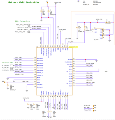

You can check their schematics for connection. E.g. this link: https://www.nxp.com/design/design-center/development-boards-and-designs/RDBESS772BJBEVB
I have also attached the schematic.
In there are used MC33772CTC1AE, MC33772C 1channel version.
With Best Regards,
Jozef
