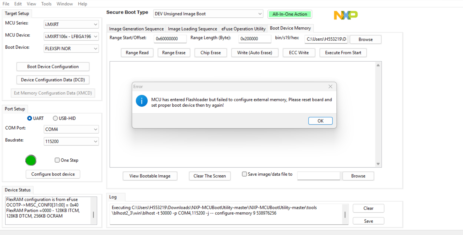

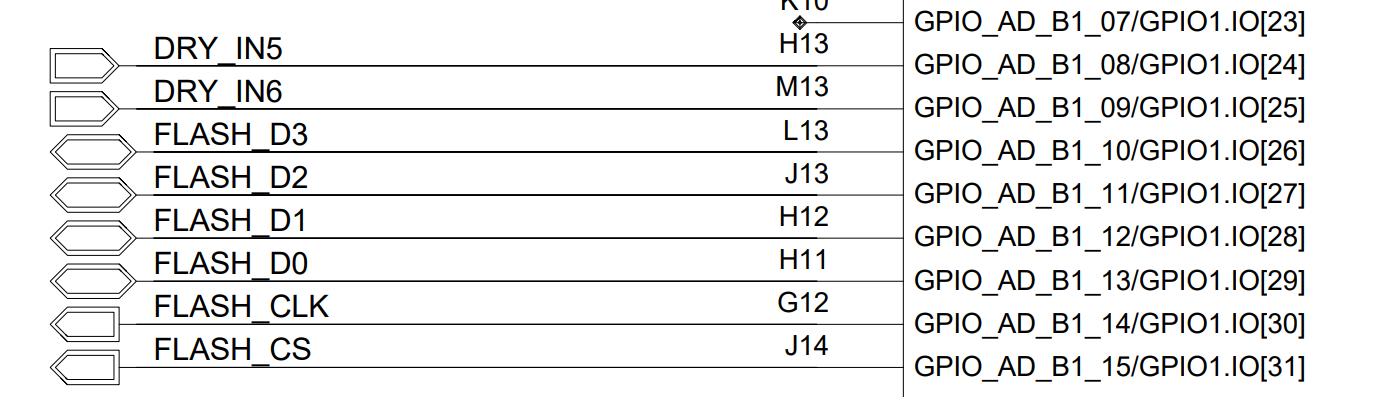

Kesavan
We have tried using the MCUBootUtility tool. We are able to successfully connect to the flashloader, but after that, when it is expected to switch to boot device mode, it does not proceed further and instead reports the error “failed to configure external memory.”
We have attached a screenshot of the error message for your reference.
Additionally, please note that on our custom board, we are not using the default QSPI/FlexSPI pin configuration. The FlexSPI signals are routed to different pins on our hardware. We have attached the detailed pin‑mapping information for reference.
Could you please advise whether any additional configuration or changes are required when using non‑default QSPI/FlexSPI pins, to ensure successful external flash detection during the boot utility flow?
we have attached images for your reference
