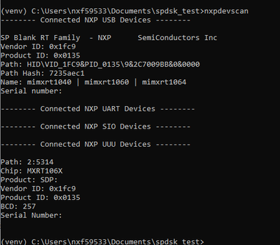

Regarding your issue, please test in the following way, it takes arround 3 minutes.
1 Create a new folder and open a CMD window.
2 Install the SPSDK tool  in your OS,  by typing the commands listed in this guide https://spsdk.readthedocs.io/en/latest/usage/installation.html
3 Get the MCU into serial downloader mode and attach it to your PC.
4 In the CMD type nxpdevscan and share with me the results. Below an example, of a MCU that can be successfully programmed over USB serial downloader mode.

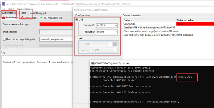

However, I have an update for my previous suggestion.
If you already installed the MCUxpresso Secure Provisioning Tool v9 or above, you do not need to install the SPSDK, as you can open a CMD prompt and use the SPSDK installed for your SPT release. See the below example:
This way, you can test more easily and without installing more things.

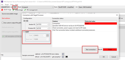

Some couple of things I would check then are:
1 Check connection using our MCUXpresso Secure Provisioning Tool , to this help us to rule out any MCU Boot Utility issue. The connection can be done this way.
2 Given your goal to program and run an application, you can check if it is possible to establish connection with the ROM bootloader but using LPUART1 pins. The pins that the bootrom uses are here.
You mentioned about USB problems so we can discard USB temporally and focus on getting something running on the MCU.
