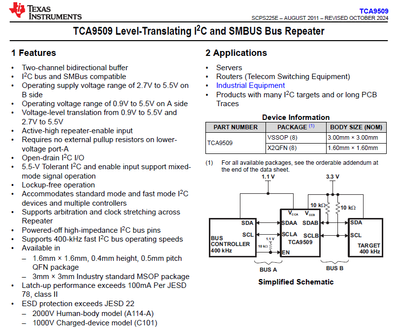

Hi Team,
We are currently searching for alternative solution for TI's level translator TCA9509, can you help to advise which NXP chip can be the best option?
Thanks.

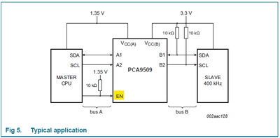

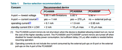

guoweisun
HI Boler
Please see below picture circled parts for replace TI part!

Boler
Hi Guowei,
Thanks a lot for your quick update.
PCA9509 should be the best option for our application.
By the way,  can you help to advise if any design consideration for the EN pin of PCA9509?
Can I just connect the EN pin to VCCA via a 10k resistor?
Or it also can be connected to VCCB?

guoweisun
HI Boler
Connect the EN pin to VCCA via a 10k resistor should be OK.
Thanks!
