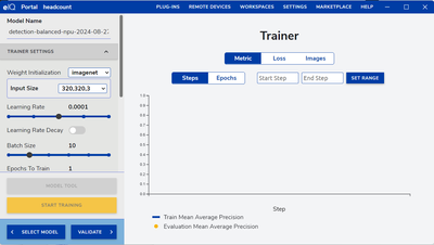

I would like to train a model using own dataset via eIQ Toolkit. I had conformed my dataset to the VOC dataset format mentioned in eIQ Toolkit. Here is a screenshot of my dataset. My dataset image size is fixed at 640x640.

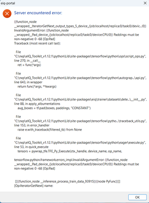

However, when I proceed to training of the model, the following errors show up. The settings are all the default settings that eIQ Toolkit. I did not change any parameter.
FYI, I selected "Detection > Balanced > NPU" for my model. I also tried with other available models, but all failed. How to resolve?

Which product are you using?
1,207 Views
JKTan
I am using i.MX8MPlus EVK board. By my understanding, eIQ Toolkit should be product independent, right?
JK
1,192 Views
jimmychan
Could you send me the dataset? so I could try it on my side.
