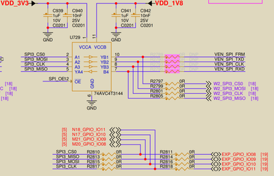

I am interfacing TI TUSS7740 with the i.MX93 FRDM board, the TUSS communicates over SPI
I connected the TUSS SPI to the imx93 LPSPI 3  according to the FRDM schematics:

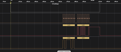

I run the test to read the TUSS chip ID :
spidev_test -D /dev/spidev0.0 -s 500000 -b 8 -H -p "\xBA\x00" -v
and I always read zeros :
root@imx93frdm:~# spidev_test -D /dev/spidev0.0 -s 500000 -b 8 -H -p "\xBA\x00" -v
spi mode: 0x1
bits per word: 8
max speed: 500000 Hz (500 kHz)
TX | BA 00 __ __ __ __ __ __ __ __ __ __ __ __ __ __ __ __ __ __ __ __ __ __ __ __ __ __ __ __ __ __ |..|
RX | 00 00 __ __ __ __ __ __ __ __ __ __ __ __ __ __ __ __ __ __ __ __ __ __ __ __ __ __ __ __ __ __ |..|
But in the logic analyzer, I see a correct communication :
What am I missing?

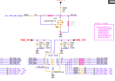

Hi @BaselHn
Yes, you are right: pinctrl-assert-gpios = <&pcal6408 0 GPIO_ACTIVE_HIGH>; in DTS activates the SPI3 to Wi-Fi PHY level converter。
You can remove it from the dts file.

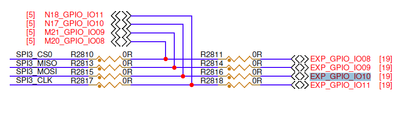

pengyong_zhang
hI @BaselHn
You mean this level shifter? It seems from 3.3V to 1.8V, you disconnect the R2797 R2799 R2801 R2805, then resolve the problem?
B.R
851件の閲覧回数
BaselHn
Hi @pengyong_zhang
Yes, I also disconnected R2810, R2813, R2815, and R2817. Then it solved the problem.

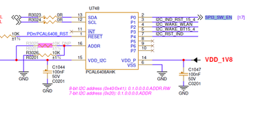

I think that this line is the problem: pinctrl-assert-gpios = <&pcal6408 0 GPIO_ACTIVE_HIGH>;
It enables the level shifter according to the schematics:
The SPI3_SW_EN is connected to :
Which is defined in the DTS :).  I think the problem has stood since the Tuss tries to raise the line to 3.3 volts and the level shifter makes it 1.2 volts, because of the misconfiguration in the DTS, which enables the level shifter to the MAYA wi-fi PHY.
Can you confirm this?

BaselHn
I managed to solve the problem, the imx93 frdm has a wifi module which is also connected to the same SPI with a level shifter, the level shifter cuase the MISO line to be always at 1.2 volt level, then the SPI always see's 0 logic on the line, once I disconnect the SPI from the level shifter, (removing the zero resistors) every thing works fine.

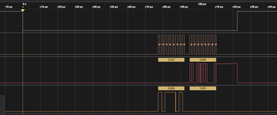

Hi @pengyong_zhang
I tried to run the test from the terminal:
spi mode: 0x1
bits per word: 8
Also, I tried to run this C code :
#include <stdio.h>
#include <stdint.h>
#include <fcntl.h>
#include <unistd.h>
#include <sys/ioctl.h>
#include <linux/spi/spidev.h>
#include <string.h>
#include <errno.h>
int main() {
int fd = open("/dev/spidev0.0", O_RDWR);
if (fd < 0) {
perror("open");
return 1;
uint8_t mode = SPI_MODE_1;
uint8_t bits = 8;
uint32_t speed = 500000;
if (ioctl(fd, SPI_IOC_WR_MODE, &mode) < 0 ||
ioctl(fd, SPI_IOC_WR_BITS_PER_WORD, &bits) < 0 ||
ioctl(fd, SPI_IOC_WR_MAX_SPEED_HZ, &speed) < 0) {
perror("SPI setup");
close(fd);
return 1;
uint8_t tx[2] = { 0xBA, 0x00 }; // Example: read reg 0x1D
uint8_t rx[2] = { 0 };
struct spi_ioc_transfer tr = {
.tx_buf = (__u64)(uintptr_t)tx,
.rx_buf = (__u64)(uintptr_t)rx,
.len = 2,
.speed_hz = speed,
.bits_per_word = bits,
.cs_change = 0,
int ret = ioctl(fd, SPI_IOC_MESSAGE(1), &tr);
if (ret < 1) {
perror("SPI_IOC_MESSAGE");
close(fd);
return 1;
printf("TX: 0x%02X 0x%02X\n", tx[0], tx[1]);
printf("RX: 0x%02X 0x%02X\n", rx[0], rx[1]);
printf("Received Device ID: 0x%02X\n", rx[1]);
close(fd);
return 0;
In both, I get the same result. In the following snapshot, you can see the logic analyzer:
