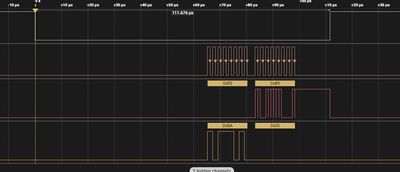

But in the logic analyzer, I see a correct communication :
What am I missing?

BaselHn
I managed to solve the problem, the imx93 frdm has a wifi module which is also connected to the same SPI with a level shifter, the level shifter cuase the MISO line to be always at 1.2 volt level, then the SPI always see's 0 logic on the line, once I disconnect the SPI from the level shifter, (removing the zero resistors) every thing works fine.

BaselHn
Hi @pengyong_zhang
I run the loopback test, and I see data on the MISO pin. The problem occurs when I connect the MISO and MOSI to the TUSS. I see the data with the logic analyzer, but I did not receive the data on the SOC side.
