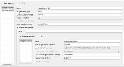

Is this possible scenario for S32R45? If so, can we make u-boot only image without IVT+QSPI reconf+DCD+HSE? What I found in mamual is the way of makeing u-boot image with them. Otherwise, Are there any other guided scenario for M7 bootloader to activate A53 in NXP?
Attached image is the S32DS bootsource configuration for better understanding

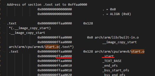

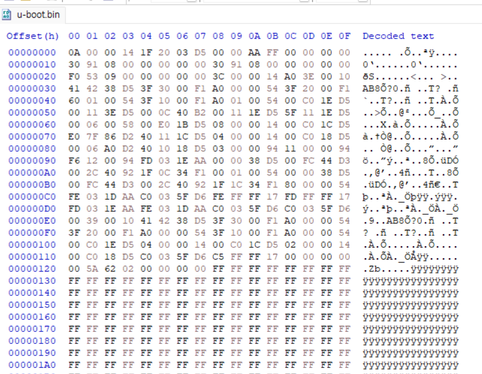

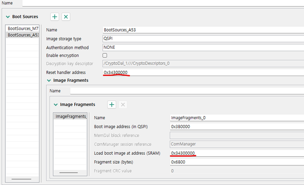

Thanks, we got u-boot.bin as follows. It seems that it has only u-boot image.
We need to locate it in SRAM, especially on 0x34300000. The application bootloader(m7) copies u-boot.bin from external flash to SRAM(0x34300000) and A53 core starts with it.
However u-boot.bin seems to be built to start with 0xffaa0000 based on map file. Could we change the start address of u-boot.bin to 0x34000000? If so, how can we do it?

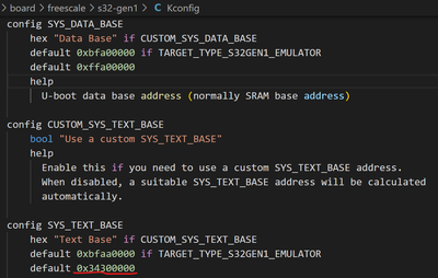

ssong
u-boot.bin's start address changed with the modification of board\freescale\s32-gen1\Kconfig's SYS_DATA_BASE default value from 0xffaa0000 to 0x34300000
Please confirm this way of modification is correct.
Do we have to change SYS_DATA_BASE accordingly?. It seems that we don't need to change it as we analyze the .map file.

alejandrolozan1
Yes, you have to modify both macros to change the starting point of uboot. This can be achieved in the menuconfig as shown below.
Saludos,
Alejandro

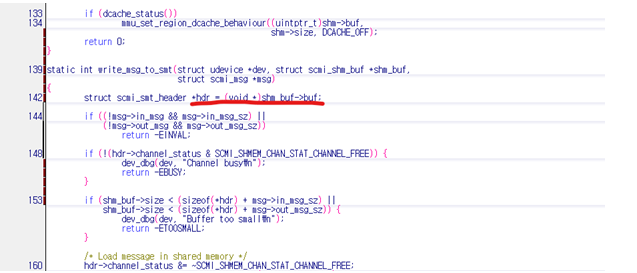

Even though SYS_TEXT_BASE, SYS_DATA_BASE changed from DRAM to SRAM, u-boot seems to access to DRAM, especially 0xD00000000 on function(write_msg_to_smt) as below:
shm_buf->buf is the pointer to 0xD0000000 which has not been initialized in M7 bootloader.
There seems to be two ways for this:
1) M7 bootloader initializes external DRAM
2) u-boot initializes external DRAM before access to it.
I tried way 1) with DDR tool in S32Ds, but failed. Could you give us the example project for it?
Could you let me know the way of initializing DRAM in u-boot?

alejandrolozan1
In latest BSP (BSP32) the DDR initialization was moved to the ATF. U-boot does not perform this initialization anymore.
In fact, if you want to use BSP32 I would suggest you to start taking a look at ATF first.
The default and quite general boot process is this :
  1. ATF is loaded in SRAM and starts execution
  2. Initializes DDR and moves Uboot to DDR
  3. ATF releases control to U-Boot.
If you want the M7 to act as the first load stage, I would suggest you execute this bootloader in a SRAM section different from the ATF. If your bootloader is not too large, maybe you can fit bootloader and ATF+Uboot (fip.s32) in the SRAM. Of course you have to be also aware of the clock changes as the ATF manages this.

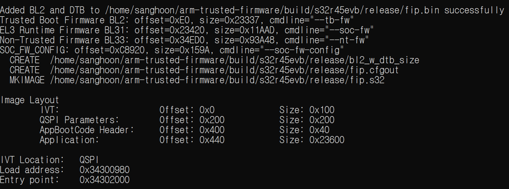

fip.bin was generated as follows:
> make CROSS_COMPILE=/home/sanghoon/toolchain/gcc-arm-10.2-2020.11-x86_64-aarch64-none-linux-gnu/bin/aarch64-none-linux-gnu- ARCH=aarch64 PLAT=s32r45evb BL33=/home/sanghoon/u-boot/u-boot-s32.bin FIP_MEMORY_OFFSET=0x34300980
fip.bin, which has bl2+bl31+bl33, was loaded in SRAM(base=0x34300980) and M7 bootloader jumped to 0x34302000 so that layout is as follows:
------------------------------ 0x34302000
               bl2
------------------------------ 0x34323DA0 (0x343023420+980)
               bl31
bl2 initialize and use the SRAM for their data section from 0x34323DC0 until 0x34340000 and it overlaps bl31's code section. Unfortunately, bl31's code section is corrupted by data of bl2.
Could you let me know how to solve it?

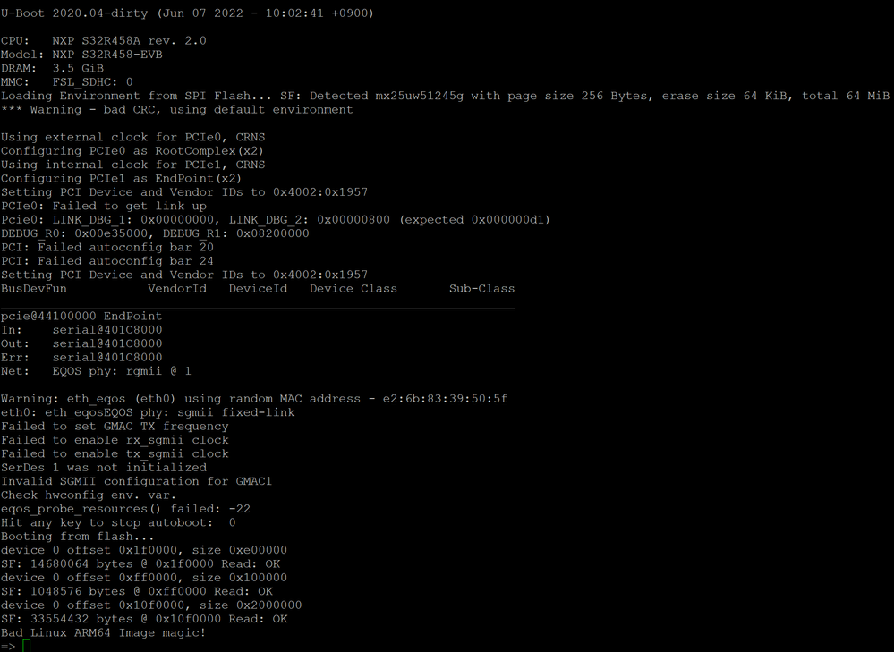

With those modification. U-boot shell appeared as follows:
Something weird is that PCIe and eth0 setup fails. SDK directly was given from NXP still has same problem.

ssong
eth0 functions well.
log on the screen below counfused me.
"eth0: eth_eqosEQOS phy: sgmii fixed link"
phy: sgmii fixed link might be for eth1. It's better to let it go to the next line.
16,300 Views
alejandrolozan1
Even in NXP EVB with the default fip.s32 image the ethernet 1 and pcie fail. This is expected if the SGMII phy is not initialized nor connected to  GMAC1 and PCIe is expected to fail in case there aren't any PCIe devices connected so the link works succesfully.
So this behavior is expected.

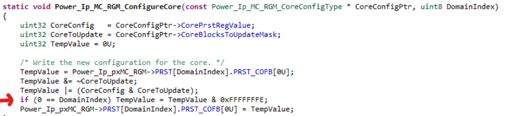

In M7 bootloader which was provided in S32DS, Power_Ip_MC_RGM_ConfigureCore API resets M7_0 Core so that M7 bootloader can't proceed anymore.
Below temporal code has been added in-between not to reset M7_0 core.
Can we the API make M7_0 core not to be reset by the API with the configuration change? Otherwise, some bugs exist in code?

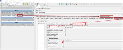

GaryRK
Yes it is possible to configure the Mcu driver to avoid this reset of M7_0 core when the bootloader is running. Here are the steps:
  1. Open the S32 Config Tools Peripheral tool on the bootloader project.
  2. On the left hand side there is the Components view, select Mcu_1.
  3. Then navigate through tabs McuModuleConfiguration -> McuModeSettingConf -> McuPartitionConfiguration -> McuPartition0Config.
  4. Under McuCore0Configuration un-check the box "CM7_0 Under MCU Control".
See below image for reference.
