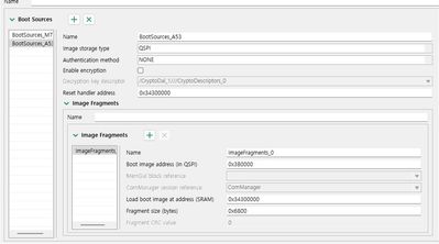

Following is the scenario we want:
** Flash Layout for boot **
Exported Blob                                                                                |
(IVT + QSPI reconf + DCD + HSE + Application bootloader(M7)) |
Application for M7                                                                          |
u-boot for A53                                                                                |
1. Application bootloader downloads Application for M7 and u-boot for A53
2. Application bootloader activates A53 and M7
3. u-boot in A53 configures hardware and downloads kernel for A53 from DRAM
4. u-boot jumps to kernel for A53
Is this possible scenario for S32R45? If so, can we make u-boot only image without IVT+QSPI reconf+DCD+HSE? What I found in mamual is the way of makeing u-boot image with them. Otherwise, Are there any other guided scenario for M7 bootloader to activate A53 in NXP?
Attached image is the S32DS bootsource configuration for better understanding

aiweixin
    I want to create a bootloader project to start up M7 and A53 core,how can i do for it?
    Can you help me, Some doc or idea?
    Additionally, where can i configure it as shown in attached image?

Yes this is a valid boot scenario for S32R45. The NXP BootROM FW will read and process the [IVT + QSPI reconf + DCD + HSE] then boot the [Application bootloader (M7)] which can load the [Application for M7] and then [u-boot for A53].
I don't understand this question: "can we make u-boot only image without IVT+QSPI reconf+DCD+HSE?"
The [IVT + QSPI reconf + DCD + HSE] is needed only for the primary bootloader (or application) which is loaded by the NXP BootROM FW. For the scenario you describe it is not necessary to pre-pend these structures to the u-boot image because it is your [application bootloader (M7)] that will perform the loading of u-boot, not the BootROM FW.
You can also configure to have the BootROM FW target the A53 as boot core and boot u-boot directly, it does not need to be the M7 core that starts first. Is this what you mean? The S32R45 Linux BSP boots like this.
