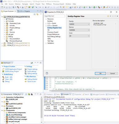

My S32DS cannot look up the register table.
And in the "EmbSys Register View" window, it shows that "SVD descriptor not found for project PF294_Z4_0".
But I have set the register view to chip S32R294. How should I resolve this problem? Thanks.

I removed the project files ".metadata". And recreated another project file with the same source codes. It worked.
I'm not sure whether it is IDE's bug or not.

Nice to hear that.
Always try fresh project to verify if it is not any configuration/modification issue.
