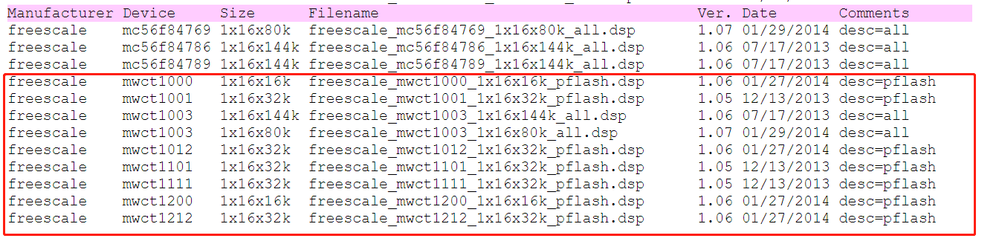

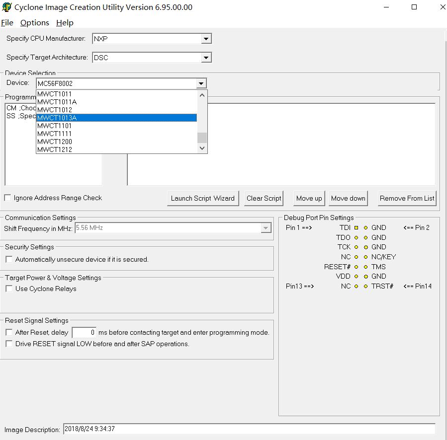

Hello Flavio Caruso,
I guess you maybe need a programmer for production.
Maybe you can use PEMicro U-Cyclone (Fx), pls refer:
PEmicro | Experts in Embedded tools for Flash Programming and Development
You can query all device supported from the following link:
It doesn't include MWCT1013, but the PC software for U-Cyclone can support it. Pls update your PC software if there is no PN MWCT1013 in your PC software.
