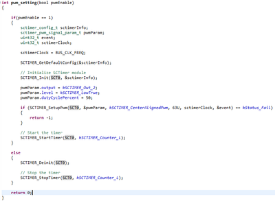

I'm using the QN9080.
I'm generating PWM using SCTimer.
I want to create a function that stops and regenerates the PWM when a specific command is received.
In the example of scimer_simple_pwm, the PWM generation has been tested, but the PWM output does not stop.
I thought using the SCTIMER_StopTimer function would stop the output at zero, but I guess not.
How can I turn the PWM output on and off?

How did you test? If possible, make some screenshots about your code.

roem
Here's the code.

nxf56274
The red circle code, you needn't put it in the function. deinit should be removed. 

roem
Thank you for your answer.
So the PWM is output with the StartTimer, and the PWM is stopped with the StopTimer?
The red circle code was in that function, so it didn't stop?
