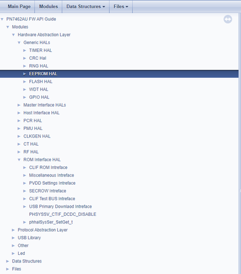

I have a question about code read/write protection levels and how they affect IAP and ISP.
If I set CWP_LEVEL to 1 by using 'phhalSysSer_Secrow_Config_t' can i continue to use 'phhalEeprom_WriteBuffer' and 'phhalFlash_WriteBuffer' functions to write data to flash & eeprom in my firmware.
If I set CRP_Level to 1 by using 'phhalSysSer_USB_Primary_Dnld_Config_t' can i continue to use 'phhalEeprom_Read' and 'phhalFlash_Read' functions to read data from flash & eeprom in my firmware.
Thanks.
1,271 Views
danielchen
I think it should can.
'phhalEeprom_WriteBuffer'  'phhalFlash_WriteBuffer‘  'phhalEeprom_Read' and 'phhalFlash_Read'   these fucntions are generic interface Hals.
CRP_Level and  DRP_Level  are for ROM interface Hals .
