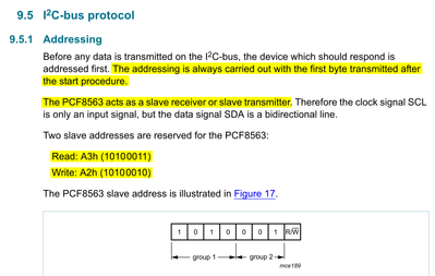

Hello, I'm using a custom board that contains 5 i2c sensors. The i2c Bus works fine. the pull-up resistors are included and when I use the I2C tool to detect the i2c connected sensors I get the following:
The above image shows that the RTC has the address 0x00 while in the datasheet of the PCF8563 it has 2 addresses depends on the read-write operation.
Does this mean that the RTC is not working
the address 0x00 is the only unknown address for me.

Hello Amir,
The 7-bit slave address of the PCF8563 is 0x51 followed by a write (0) or read (1) bit. This results in 0xA2 for a write as shown in the datasheet.
The second byte is the address of the register you want to write to. In your case Control_status_1 (0x00).
The third byte is the data you want to write to the register. In your case 0x00.
Then you can either send a stop condition or continue sending next bytes as the PCF8563 support auto incrementing of the register address.
It might be useful to use a logic analyzer or an oscilloscope to check what is going on the bus.
Tomas

Thank you Tomas......I found out that the 0x00 that I get on the bus is the ESP Address. while the RTC was missing on the board that I was using. i asked for a replacement.
