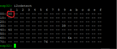

Hello, I'm using a custom board that contains 5 i2c sensors. The i2c Bus works fine. the pull-up resistors are included and when I use the I2C tool to detect the i2c connected sensors I get the following:

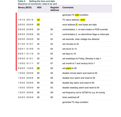

The above image shows that the RTC has the address 0x00 while in the datasheet of the PCF8563 it has 2 addresses depends on the read-write operation.
Does this mean that the RTC is not working
the address 0x00 is the only unknown address for me.
if it is working then, when I tried to follow the  User-guide_UM10301 exactly on page 27 where there is an example of how to set the PCF8563:

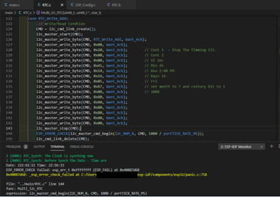

I always get an error in the i2c. my code is as follows:
(I use the ESP32 with the esspressif-idf )
        i2c_master_start(CMD);
        i2c_master_write_byte(CMD, RTC_Write_Add, Want_Ack);
        i2c_master_write_byte(CMD, control_status_1, Want_Ack);
        i2c_master_write_byte(CMD, 0x00, Want_Ack);
        i2c_master_write_byte(CMD, VL_secondsReg, Want_Ack);
        i2c_master_write_byte(CMD, 0x00, Want_Ack);        // Vl Sec 00
        i2c_master_write_byte(CMD, 0x45, Want_Ack);        // Min 45
        i2c_master_write_byte(CMD, 0x19, Want_Ack);        // Hou 7 PM
        i2c_master_write_byte(CMD, 0x12, Want_Ack);        // Days 12
        i2c_master_write_byte(CMD, 0x05, Want_Ack);        // Fri
        i2c_master_write_byte(CMD, 0x82, Want_Ack);        // set month
        i2c_master_write_byte(CMD, 0x21, Want_Ack);        // 2021
        i2c_master_stop(CMD);
        ESP_ERROR_CHECK(i2c_master_cmd_begin(I2C_NUM_0, CMD, 1000 / portTICK_RATE_MS));

1- The appearance of the address 0x00 (which is the Control_status_1 Register) as the chip address is ok
2- if it's ok, then what could be my issue

The 7-bit slave address of the PCF8563 is 0x51 followed by a write (0) or read (1) bit. This results in 0xA2 for a write as shown in the datasheet.
The second byte is the address of the register you want to write to. In your case Control_status_1 (0x00).
The third byte is the data you want to write to the register. In your case 0x00.
Then you can either send a stop condition or continue sending next bytes as the PCF8563 support auto incrementing of the register address.
It might be useful to use a logic analyzer or an oscilloscope to check what is going on the bus.

Thank you Tomas......I found out that the 0x00 that I get on the bus is the ESP Address. while the RTC was missing on the board that I was using. i asked for a replacement.
