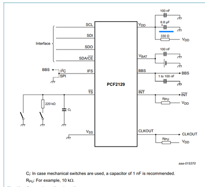

JozefKozon
Hi Julian,
I have checked your schematic again and I am missing the bulk capacitor on the VDD pin. Please refer to the Figure 48. in the PCF2129 datasheet. Because the direct switch to battery helped to diminish the issue, I suspect that without the 6.8uF bulk capacitor the internal operating voltage drops too low causing the oscillator to stop temporarily in some cases. Please try to add the 6.8uF capacitor on the VDD pin, which might hold the internal operating voltage at proper value during the battery switching.
With Best Regards,
Jozef
36,895件の閲覧回数
JozefKozon
Hi Julian,
I apologize for sending you another update. I am reading an AN11186, because of another case, and in section 5.3 an RC network on the VDD pin is recommended. Please check it an if the 6.8uF bulk capacitor doesn't help, please try to add the 330Ohm resistor.

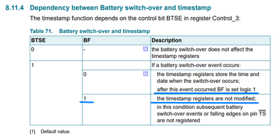

JozefKozon
Dear Julian,
I presume the time error occurs on the devices where the battery switch happens second time. Please refer to section 8.11.4 and Table 71. in the PCF2129 datasheet. If the battery switch occurs for the first time, the time and date are stored in the timestamp registers, because the BF bit in the Control_3 register is set to 0 by default, but after the battery switch occurs, the BF bit is set to logic 1 and in the next battery switch the timestamp registers are not modified.
Please set the BF bit to logic 0 after the battery switch occurs. This should solve the issue with time errors.

juliancox
Contributor V
THank you for this information. I have not yet had an opportunity to test it, but I hope you can explain something.
I understand what the timestamp registers are for, but how does this affect the contents of the time registers. Why should they change when all the timestamp registers do is to record the time at which an event occurred?
37,281件の閲覧回数
JozefKozon
Dear Julian,
you are right. I posted my answer too hastily. The timestamp registers will most probably not affect the time registers. Could you please check the section 8.8.8 in the PCF2129 datasheet? Could you please confirm, that the all accesses are completed within one second? Also is the reading access made in one go?

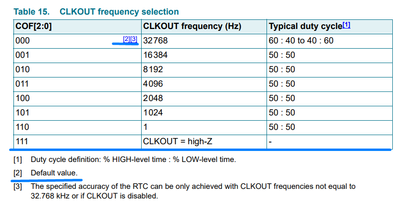

The functionality of the battery switch-over is limited by the fact that the power supply VDD is monitored every 1 ms in order to save power consumption. Considering that the battery switch-over threshold value (Vth(sw)bat) is typically 2.5 V, the power management operating limit (VDD(min)) is 1.8 V and that VDD is monitored every 1 ms, the battery switch-over works properly in cases where VDD falls with a rate lower than 0.7 V/ms. Could you please provide oscilloscope waveform of VDD, VBAT and CLKOUT during the VDD switchover event?
What are the settings for COF[2:0] and PWRMNG[2:0] bits?

juliancox
Contributor V
COF[2:0] is 000 (default)
PWRMNG[2:0]] is 000 (default)

JozefKozon
Dear Julian,
thank you for the schematic and the scopes. So the too high fall rate is not the reason. 16mV/ms is way lower, than 700mV/ms.
I have two suggestions. Please test them.
1. Please disable the CLKOUT output by the COF[2:0] bits in the CLKOUT register, address 0Fh. This probably will not help, but please test it.
2. This suggestion might solve your issue. How are set the PWRMNG [2:0] bits in the Control_3 register, address 02h? Are they left default?
