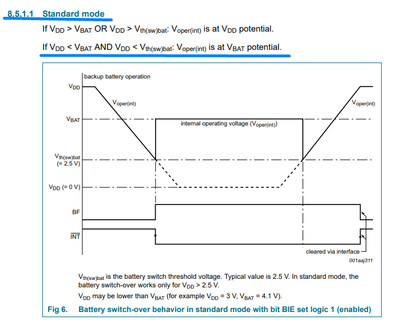

The functionality of the battery switch-over is limited by the fact that the power supply VDD is monitored every 1 ms in order to save power consumption. Considering that the battery switch-over threshold value (Vth(sw)bat) is typically 2.5 V, the power management operating limit (VDD(min)) is 1.8 V and that VDD is monitored every 1 ms, the battery switch-over works properly in cases where VDD falls with a rate lower than 0.7 V/ms. Could you please provide oscilloscope waveform of VDD, VBAT and CLKOUT during the VDD switchover event?

thank you for the schematic and the scopes. So the too high fall rate is not the reason. 16mV/ms is way lower, than 700mV/ms.

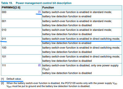

2. This suggestion might solve your issue. How are set the PWRMNG [2:0] bits in the Control_3 register, address 02h? Are they left default?
Please set to bits to 011 to direct switching mode, so the internal operating voltage doesn't drop to Vth(sw)bat, but switches to VBAT supply when the  VDD < VBAT.

Thank you for the suggestions - I will try them. I have been reluctant to try the Direct Mode because VDD is 3.3V and VBATT is 3.0V.
