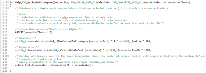

i2dNativeValue = Chip_I2D_GetValue(NSS_I2D); //integer value
/* Conversion en PicoAmp */
i2dValue = Chip_I2D_NativeToPicoAmpere(i2dNativeValue, I2D_SCALER_GAIN_10_1, I2D_CONVERTER_GAIN_HIGH, 100);

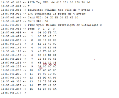

 I first used the NDEFT2 message to pass an integer =1234 to the NFC memory , works fine, next figre

 I first used the NDEFT2 message to pass an integer =1234 to the NFC memory , works fine, next figure (read using ARduino and RC522)
I want first to check the value of the current through the 75k resistor
But I'm confused, when I replace the integer by native I2D value, the same bytes have a strange values
Questions:
1) what is the I2D conversion equation from native to value?

2) The conversion function from native to pA is in SDK  lib_chip_nss/src/i2d_nss.c, line 218 and following. The formula and some explanation on the calculation is in the comment field.
Kind regards,

The NDEF message in the case of "adc_value = i2dNativeValue" is 0x30 0x00, which is the C string "0".
So the i2dNativeValue must have been zero when it was converted to ascii by itoa().

Can you give me the equation converting i2d native into pA?
